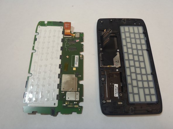

  9. Motorola Droid 4 Motherboard Replacement, Motherboard: crwdns2935265:09crwdnd2935265:01crwdnd2935265:02crwdne2935265:0 Motorola Droid 4 Motherboard Replacement, Motherboard: crwdns2935265:09crwdnd2935265:02crwdnd2935265:02crwdne2935265:0
    • The Motherboard is the brain of the phone, handle with care.
    • Using the spudger, separate the motherboard from the keyboard frame.
    • Tilt the motherboard upward from the side of the charger connection as shown in the picture.
  10. Motorola Droid 4 Motherboard Replacement, Disconnecting the Motherboard: crwdns2935265:010crwdnd2935265:01crwdnd2935265:02crwdne2935265:0 Motorola Droid 4 Motherboard Replacement, Disconnecting the Motherboard: crwdns2935265:010crwdnd2935265:02crwdnd2935265:02crwdne2935265:0
    • Using the spudger, gently disconnect the two motherboard connections.
    • Once the motherboard is separated from the phone place it in a safe place.
