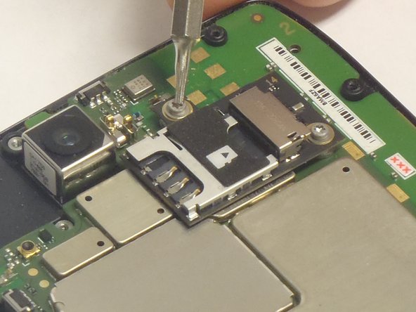

  9. Motorola Droid 4 MicroSD/SIM Card Reader Replacement, MicroSD/SIM Card Reader: crwdns2935265:09crwdnd2935265:01crwdnd2935265:03crwdne2935265:0 Motorola Droid 4 MicroSD/SIM Card Reader Replacement, MicroSD/SIM Card Reader: crwdns2935265:09crwdnd2935265:02crwdnd2935265:03crwdne2935265:0 Motorola Droid 4 MicroSD/SIM Card Reader Replacement, MicroSD/SIM Card Reader: crwdns2935265:09crwdnd2935265:03crwdnd2935265:03crwdne2935265:0
    • Once the Motherboard Housing is removed the complete Micro SD/SIM card reader is exposed, as indicated by the picture.
    • Remove the two screws that attach the reader to the Motherboard. The locations of the screws are indicated in the picture.
  10. Motorola Droid 4 MicroSD/SIM Card Reader Replacement, Separate the reader from the motherboard: crwdns2935265:010crwdnd2935265:01crwdnd2935265:03crwdne2935265:0 Motorola Droid 4 MicroSD/SIM Card Reader Replacement, Separate the reader from the motherboard: crwdns2935265:010crwdnd2935265:02crwdnd2935265:03crwdne2935265:0 Motorola Droid 4 MicroSD/SIM Card Reader Replacement, Separate the reader from the motherboard: crwdns2935265:010crwdnd2935265:03crwdnd2935265:03crwdne2935265:0
    • Using the spudger, pry off the Reader.
    • Be careful while removing the Reader. The connection to the motherboard is composed of small pins.
