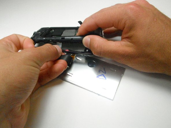

    5. Motorola Defy XT Screen Replacement: crwdns2935265:09crwdnd2935265:01crwdnd2935265:02crwdne2935265:0 Motorola Defy XT Screen Replacement: crwdns2935265:09crwdnd2935265:02crwdnd2935265:02crwdne2935265:0
      • Slide the screen out and disconnect the ribbon cable connecting the display to the motherboard by pulling straight outward.
      • Potential for device damage: Be careful when sliding out the screen because the front case and the motherboard are still connected by two other ribbon cables.
    6. Motorola Defy XT Screen Replacement: crwdns2935265:010crwdnd2935265:01crwdnd2935265:02crwdne2935265:0 Motorola Defy XT Screen Replacement: crwdns2935265:010crwdnd2935265:02crwdnd2935265:02crwdne2935265:0
      • Set the old screen aside and replace it with your new screen.
