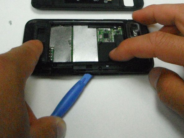

      • Wedge the opening tool in-between the back cover and the body of the phone in the opening denoted by the arrow.
    2. Motorola Defy XT Logic Board Replacement: crwdns2935265:02crwdnd2935265:01crwdnd2935265:01crwdne2935265:0
      • Once wedged in the opening, slide the opening tool around the side of the phone and remove the back cover, setting it aside.
