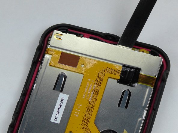

    1. Motorola Defy LCD Replacement, Removing the LCD: crwdns2935265:09crwdnd2935265:01crwdnd2935265:02crwdne2935265:0 Motorola Defy LCD Replacement, Removing the LCD: crwdns2935265:09crwdnd2935265:02crwdnd2935265:02crwdne2935265:0
      • Stick the metal spudger in between the LCD screen and the case of the phone.
      • Remove the LCD screen and replace with a new one.
