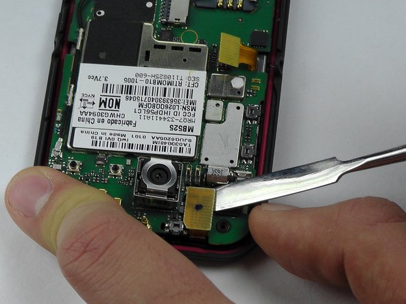

  6. Motorola Defy Earpiece Speaker Replacement, Motherboard: crwdns2935265:06crwdnd2935265:01crwdnd2935265:02crwdne2935265:0 Motorola Defy Earpiece Speaker Replacement, Motherboard: crwdns2935265:06crwdnd2935265:02crwdnd2935265:02crwdne2935265:0
    • Use metal spudger to pry off the middle yellow flap carefully.

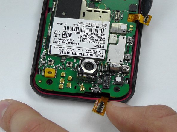

  7. Motorola Defy Earpiece Speaker Replacement: crwdns2935265:07crwdnd2935265:01crwdnd2935265:03crwdne2935265:0 Motorola Defy Earpiece Speaker Replacement: crwdns2935265:07crwdnd2935265:02crwdnd2935265:03crwdne2935265:0 Motorola Defy Earpiece Speaker Replacement: crwdns2935265:07crwdnd2935265:03crwdnd2935265:03crwdne2935265:0
    • Use tweezers again to pry off the second yellow flap carefully.
  8. Motorola Defy Earpiece Speaker Replacement: crwdns2935265:08crwdnd2935265:01crwdnd2935265:01crwdne2935265:0
    • The motherboard is the whole green board. Pry it off carefully with tweezers from the sides and place it aside.

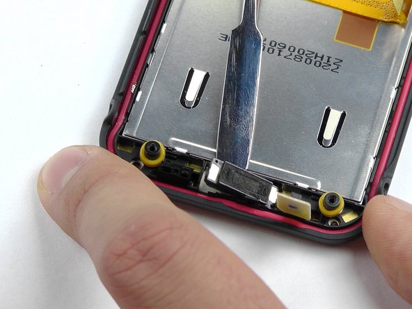

  9. Motorola Defy Earpiece Speaker Replacement, Remove the earpiece speaker: crwdns2935265:09crwdnd2935265:01crwdnd2935265:02crwdne2935265:0 Motorola Defy Earpiece Speaker Replacement, Remove the earpiece speaker: crwdns2935265:09crwdnd2935265:02crwdnd2935265:02crwdne2935265:0
    • Once the motherboard is removed, use either the metal tweezers or the metal spudger to remove the speaker by prying it as shown.
    • The speaker is glued to its position, thus you will have to glue the new one back on.
    • The speaker must be pried off carefully. It is very delicate.
