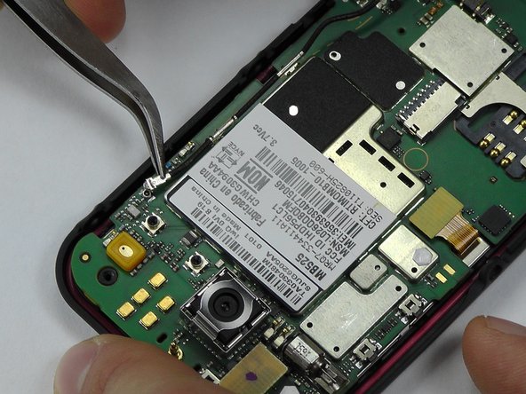

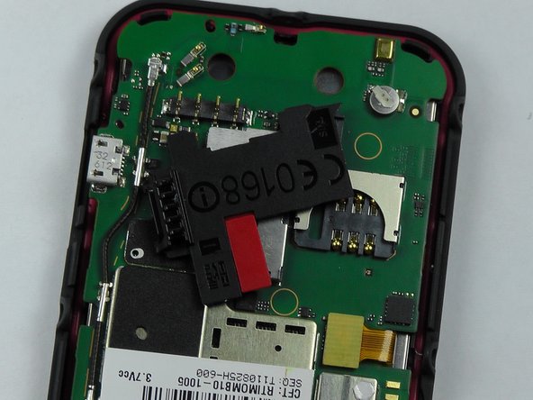

    1. Motorola Defy Antenna Replacement, Antenna: crwdns2935265:04crwdnd2935265:01crwdnd2935265:02crwdne2935265:0 Motorola Defy Antenna Replacement, Antenna: crwdns2935265:04crwdnd2935265:02crwdnd2935265:02crwdne2935265:0
      • Take the metal spudger and pry the black piece, where the sim card goes, off to get to the entire antenna.
    2. Motorola Defy Antenna Replacement: crwdns2935265:05crwdnd2935265:01crwdnd2935265:03crwdne2935265:0 Motorola Defy Antenna Replacement: crwdns2935265:05crwdnd2935265:02crwdnd2935265:03crwdne2935265:0 Motorola Defy Antenna Replacement: crwdns2935265:05crwdnd2935265:03crwdnd2935265:03crwdne2935265:0
      • Pry the antenna off using the metal spudger and tweezers and replace with the new one.
