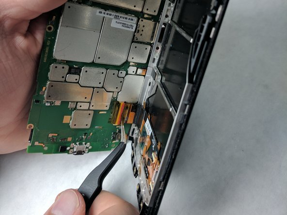

  4. Motorola DROID MAXX Full Screen  Replacement: crwdns2935265:04crwdnd2935265:01crwdnd2935265:03crwdne2935265:0 Motorola DROID MAXX Full Screen  Replacement: crwdns2935265:04crwdnd2935265:02crwdnd2935265:03crwdne2935265:0 Motorola DROID MAXX Full Screen  Replacement: crwdns2935265:04crwdnd2935265:03crwdnd2935265:03crwdne2935265:0
    • Carefully disconnect the ribbon cable from the motherboard and front screen.
    • Place the ribbon cable under the orange tape during reassembly.
