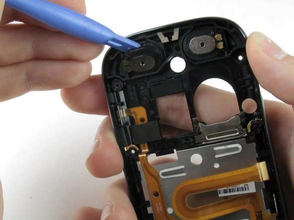

  9. Motorola Cliq Rear Speakers Replacement, Rear Speakers: crwdns2935265:09crwdnd2935265:01crwdnd2935265:02crwdne2935265:0 Motorola Cliq Rear Speakers Replacement, Rear Speakers: crwdns2935265:09crwdnd2935265:02crwdnd2935265:02crwdne2935265:0
    • Insert a plastic opening tool in the gap right above the speakers.
    • Pry upwards to lift the speaker out of its bracket.
    • The speakers are glued down and will cause a bit of resistance when prying.
    • Do not pry anywhere else because it may lead to the bracket around the speaker to break.

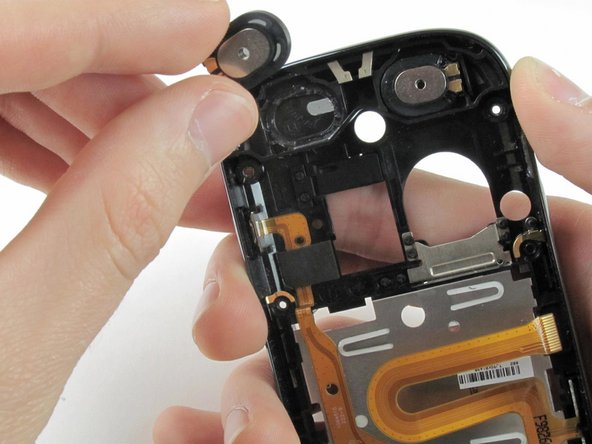

  10. Motorola Cliq Rear Speakers Replacement: crwdns2935265:010crwdnd2935265:01crwdnd2935265:02crwdne2935265:0 Motorola Cliq Rear Speakers Replacement: crwdns2935265:010crwdnd2935265:02crwdnd2935265:02crwdne2935265:0
    • With your fingers, carefully remove the speaker.
    • Repeat this process to remove the remaining speaker.
