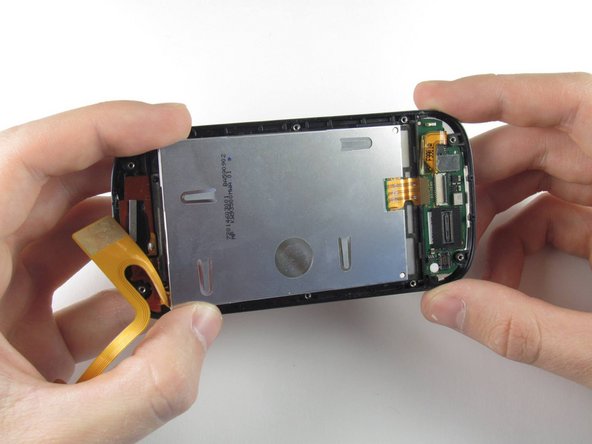

    9. Motorola Cliq LCD Screen Replacement: crwdns2935265:020crwdnd2935265:01crwdnd2935265:02crwdne2935265:0 Motorola Cliq LCD Screen Replacement: crwdns2935265:020crwdnd2935265:02crwdnd2935265:02crwdne2935265:0
      • Pry the display flex cable from its connector on the LCD shield plate with a plastic opening tool.
      • Separate the display flex cable from the LCD cover plate.

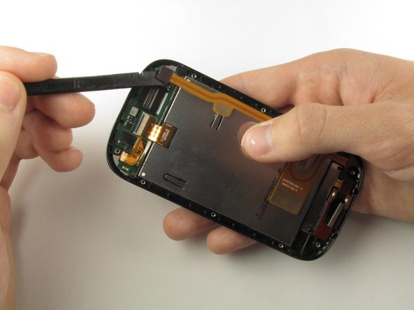

    1. Motorola Cliq LCD Screen Replacement, LCD Screen: crwdns2935265:021crwdnd2935265:01crwdnd2935265:02crwdne2935265:0 Motorola Cliq LCD Screen Replacement, LCD Screen: crwdns2935265:021crwdnd2935265:02crwdnd2935265:02crwdne2935265:0
      • Pry off the flex cable located at the top right of the display assembly using the flat end of a spudger.

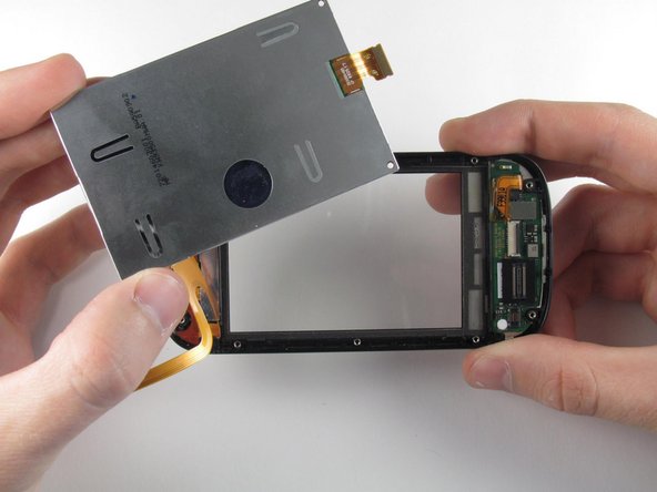

    2. Motorola Cliq LCD Screen Replacement: crwdns2935265:022crwdnd2935265:01crwdnd2935265:02crwdne2935265:0 Motorola Cliq LCD Screen Replacement: crwdns2935265:022crwdnd2935265:02crwdnd2935265:02crwdne2935265:0
      • Turn the display on its side.
      • Carefully tilt the screen of the display until the digitizer starts to fall out.
      • Do not completely separate the digitizer just yet: it is still connected to the LCD case.

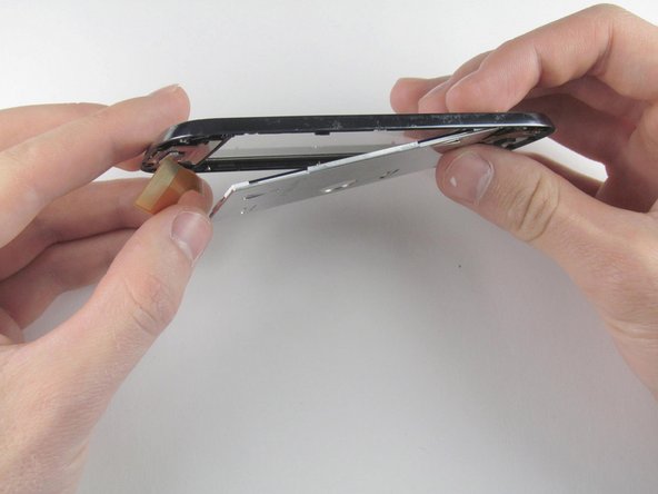

    3. Motorola Cliq LCD Screen Replacement: crwdns2935265:023crwdnd2935265:01crwdnd2935265:03crwdne2935265:0 Motorola Cliq LCD Screen Replacement: crwdns2935265:023crwdnd2935265:02crwdnd2935265:03crwdne2935265:0 Motorola Cliq LCD Screen Replacement: crwdns2935265:023crwdnd2935265:03crwdnd2935265:03crwdne2935265:0
      • With the digitizer held between two fingers, gently pull it away from the bottom of the phone until the digitizer flex cable has been completely removed from its socket.
      • Remove the digitizer.
