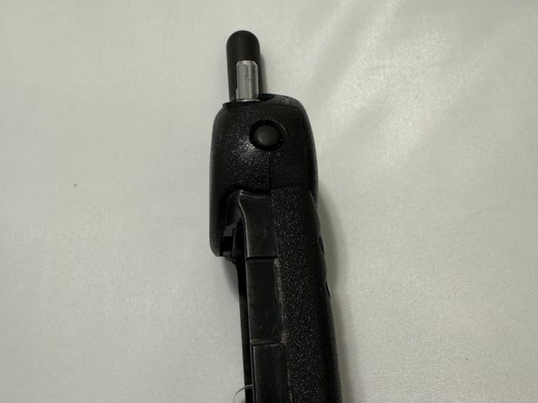

    • This Motorola CLS1410 has a damaged antenna where the rubber sheath has come off.
    • These steps also work for antennas that are bent.
    • It is recommended to discharge the battery to a safe level before attempting to replace the antenna.

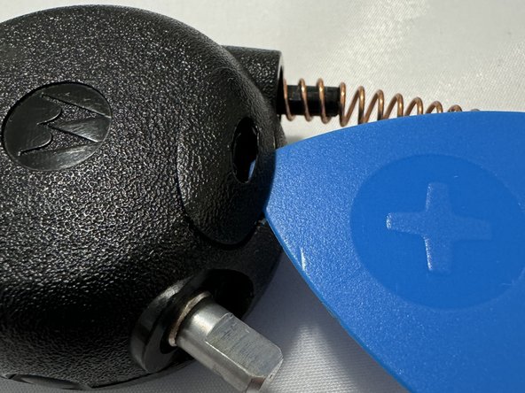

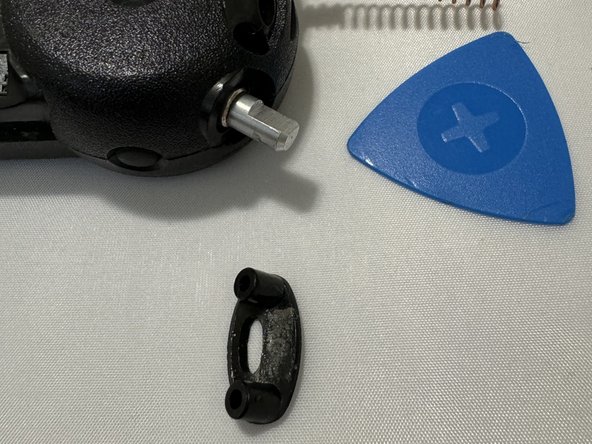

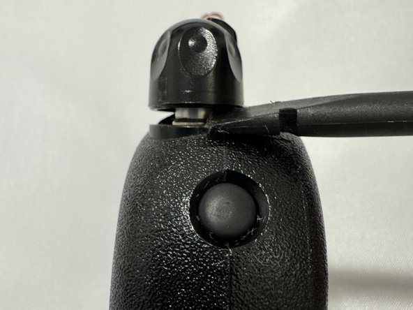

    • Insert a spudger between the body of the radio and the volume knob.
    • I've found that moving the spudger to the front of the device helps with leverage to remove the knob.
    • Use your fingers to pull the plastic knob off and set it aside.

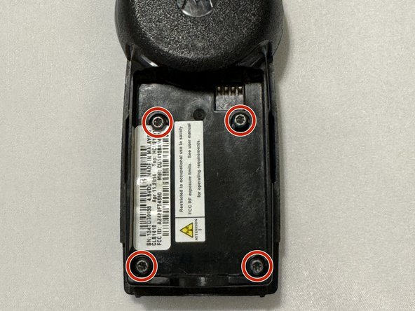

    • There are 6x T8 screws holding the back of the radio on.
    • I believe these are all the same size, but it is a good idea to set them aside so you match which screw goes to which hole.
    • Remove these 6x T8 screws.

    • Peel back the serial number sticker from this plate in the battery compartment.
    • Starting at the bottom, gently use your fingers or a spudger to separate the front and back halves of the radio.

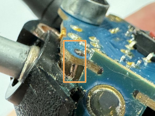

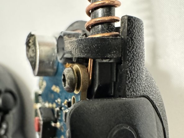

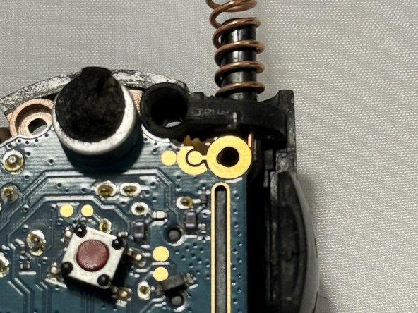

    • There is 1x T8 screw holding the antenna to the circuit board and the back of the case.
    • Remove this T8 screw and set it aside.
    • I believe this T8 screw is the same size, but continue to keep track of which one is which.

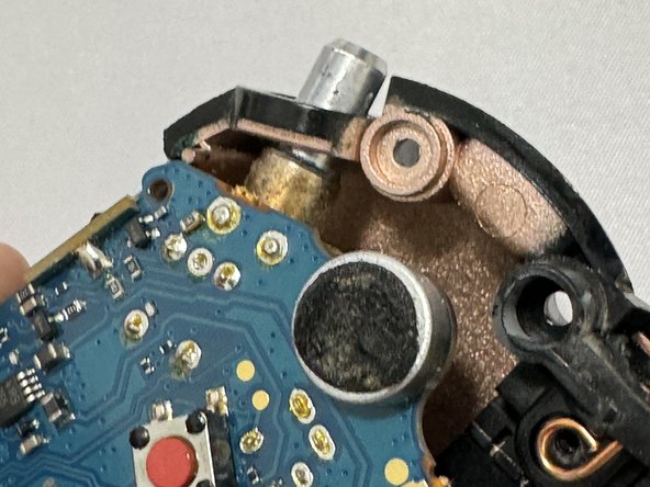

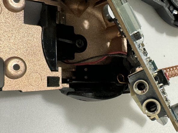

  8. Motorola CLS1410 Antenna Replacement: crwdns2935265:08crwdnd2935265:01crwdnd2935265:03crwdne2935265:0 Motorola CLS1410 Antenna Replacement: crwdns2935265:08crwdnd2935265:02crwdnd2935265:03crwdne2935265:0 Motorola CLS1410 Antenna Replacement: crwdns2935265:08crwdnd2935265:03crwdnd2935265:03crwdne2935265:0

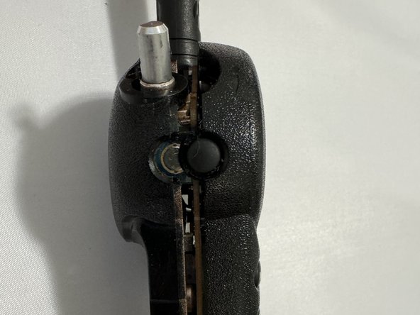

    • Gently lift the circuit board by the bottom and pivot it upwards slightly.
    • There is a small metal pin holding the board at the top left. Once you have lifted it enough to clear this, you can pull down so to remove the volume knob from its hole.
    • There are two wires from the back of the case to the circuit board. Take care to not break them when lifting the board up.

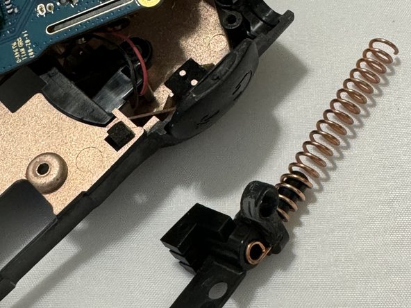

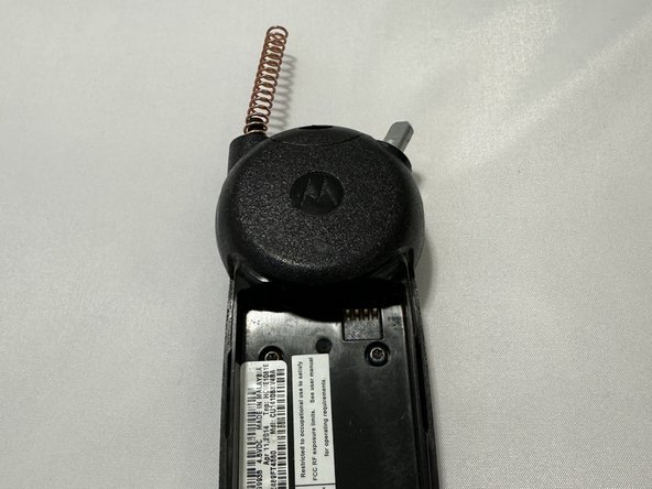

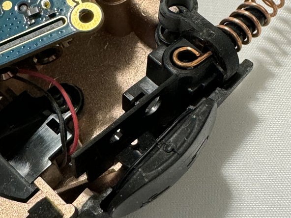

  9. Motorola CLS1410 Antenna Replacement: crwdns2935265:09crwdnd2935265:01crwdnd2935265:03crwdne2935265:0 Motorola CLS1410 Antenna Replacement: crwdns2935265:09crwdnd2935265:02crwdnd2935265:03crwdne2935265:0 Motorola CLS1410 Antenna Replacement: crwdns2935265:09crwdnd2935265:03crwdnd2935265:03crwdne2935265:0
    • Lift the antenna straight up out of the back of the case and set it aside to be recycled or disposed of.
  10. Motorola CLS1410 Antenna Replacement: crwdns2935265:010crwdnd2935265:01crwdnd2935265:02crwdne2935265:0 Motorola CLS1410 Antenna Replacement: crwdns2935265:010crwdnd2935265:02crwdnd2935265:02crwdne2935265:0
    • Set the replacement antenna into the slot.
    • Only replace the antenna with one of the same size and type.
    • You are responsible to follow all laws and regulations governing your use of this radio. Modifying this radio to accept a different type of antenna or connector may not be legal in your jurisdiction.

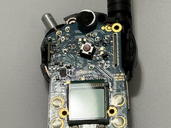

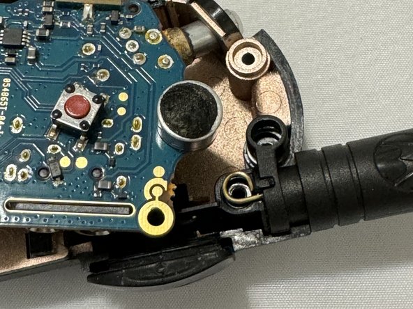

    • Slide the circuit board back into the back of the case.
    • There's a small pin on the top left of the back of the case that slots into a hole in the board. This may be a little tricky to get it to fit back in while sliding the volume knob back in.
  12. Motorola CLS1410 Antenna Replacement: crwdns2935265:012crwdnd2935265:01crwdnd2935265:03crwdne2935265:0 Motorola CLS1410 Antenna Replacement: crwdns2935265:012crwdnd2935265:02crwdnd2935265:03crwdne2935265:0 Motorola CLS1410 Antenna Replacement: crwdns2935265:012crwdnd2935265:03crwdnd2935265:03crwdne2935265:0
    • Reinstall the 1x T8 screw that holds the board to the back of the case through the antenna.
    • The antenna loop sits against the bottom of the board, not the top.
    • Set the front of the case on the rest of the radio and press together gently to get it to latch.
