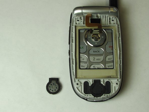

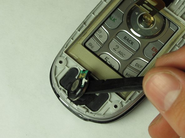

  5. Motorola C290 Speaker Replacement, Speaker Removal: crwdns2935265:05crwdnd2935265:01crwdnd2935265:03crwdne2935265:0 Motorola C290 Speaker Replacement, Speaker Removal: crwdns2935265:05crwdnd2935265:02crwdnd2935265:03crwdne2935265:0 Motorola C290 Speaker Replacement, Speaker Removal: crwdns2935265:05crwdnd2935265:03crwdnd2935265:03crwdne2935265:0
    • Insert spudger underneath the speaker.
    • Gently break the sticky seal between the phone case and speaker.
    • Lift the speaker off the phone case.
    • Note: It will be necessary to destroy the seal to remove the speaker.
