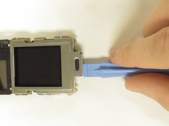

    1. Motorola C261 Screen Replacement, Front Speaker: crwdns2935265:010crwdnd2935265:01crwdnd2935265:02crwdne2935265:0 Motorola C261 Screen Replacement, Front Speaker: crwdns2935265:010crwdnd2935265:02crwdnd2935265:02crwdne2935265:0
      • Pry under the display screen, around each edge until it comes loose from the circuit board.
      • You are removing the black plastic piece that holds the button circuit board. The piece has an aluminum frame around it. The two pieces will be removed together and don't need to be separated.
    2. Motorola C261 Screen Replacement, Removing Framework: crwdns2935265:011crwdnd2935265:01crwdnd2935265:01crwdne2935265:0
      • Gently remove the plastic and metal framework of the phone by lifting it up.

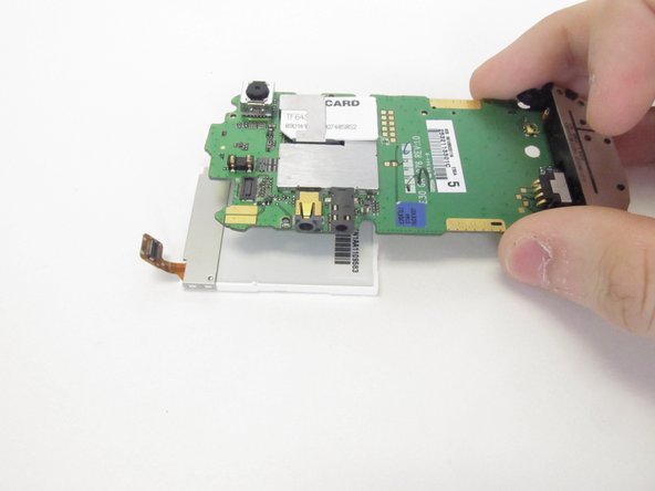

    3. Motorola C261 Screen Replacement, Removing Screen Ribbon Connection: crwdns2935265:012crwdnd2935265:01crwdnd2935265:02crwdne2935265:0 Motorola C261 Screen Replacement, Removing Screen Ribbon Connection: crwdns2935265:012crwdnd2935265:02crwdnd2935265:02crwdne2935265:0
      • Use the prying tool to remove the connection between the display screen and the the main circuit board.
      • The ribbon is not removed. It is instead connected to the circuit board by a set of circuit connectors.
