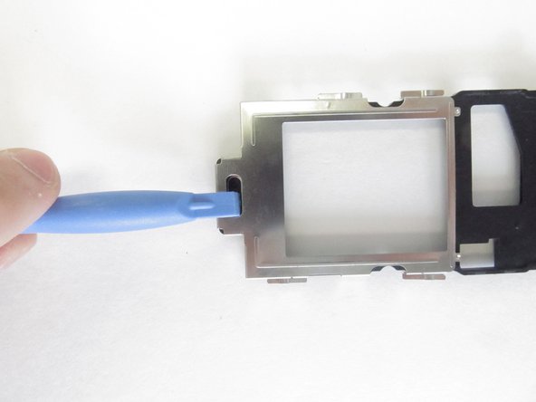

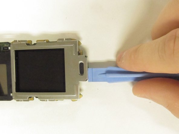

    • Pry under the display screen, around each edge until it comes loose from the circuit board.
    • You are removing the black plastic piece that holds the button circuit board. The piece has an aluminum frame around it. The two pieces will be removed together and don't need to be separated.
  7. Motorola C261 Front Speaker Replacement, Lifting Framework: crwdns2935265:07crwdnd2935265:01crwdnd2935265:01crwdne2935265:0
    • Gently remove the plastic and metal framework of the phone by picking it up.
  8. Motorola C261 Front Speaker Replacement: crwdns2935265:08crwdnd2935265:01crwdnd2935265:02crwdne2935265:0 Motorola C261 Front Speaker Replacement: crwdns2935265:08crwdnd2935265:02crwdnd2935265:02crwdne2935265:0
    • The front speaker should be contained in the framework that you just removed. Remove the speaker by lifting it out.
    • Use a tool that isn't sharp to poke it out should the first method prove too difficult.
