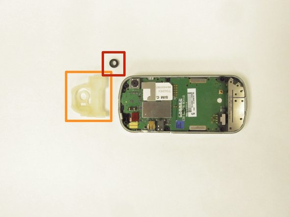

  6. Motorola C261 Button Circuit Board Replacement, Spacers: crwdns2935265:06crwdnd2935265:01crwdnd2935265:02crwdne2935265:0 Motorola C261 Button Circuit Board Replacement, Spacers: crwdns2935265:06crwdnd2935265:02crwdnd2935265:02crwdne2935265:0
    • Remove the small black circular rubber spacer.
    • Remove the white rubber spacer.
    • These pieces are small and easy to lose, especially the black one. Set them somewhere safe!

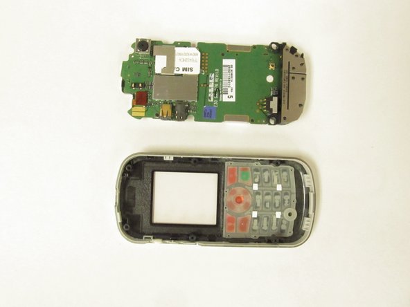

  7. Motorola C261 Button Circuit Board Replacement, Motherboard and Front Housing: crwdns2935265:07crwdnd2935265:01crwdnd2935265:02crwdne2935265:0 Motorola C261 Button Circuit Board Replacement, Motherboard and Front Housing: crwdns2935265:07crwdnd2935265:02crwdnd2935265:02crwdne2935265:0
    • Gently remove the motherboard assembly from the front housing.
    • Now, the front housing is free to be replaced, as well as the cosmetic keypad.
