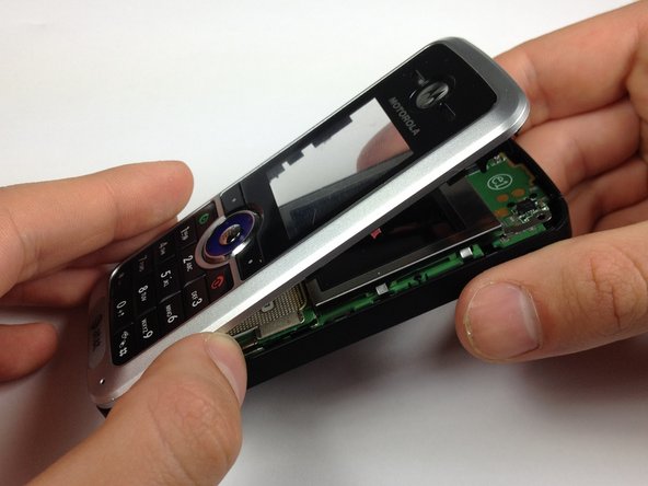

      • Lodge a spudger in between the front panel and the main frame of the phone.
      • Using a good amount of torque, pry the front panel from the phone.

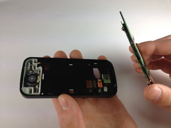

      • Place the phone on its back.
      • Insert the spudger at the bottom of the phone, between the phone's frame and the circuit board.
      • Remove the circuit board from the frame.
      • Removing the board takes more force than you would expect.

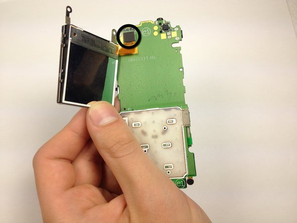

    2. Motorola C168 Screen Replacement: crwdns2935265:07crwdnd2935265:01crwdnd2935265:02crwdne2935265:0 Motorola C168 Screen Replacement: crwdns2935265:07crwdnd2935265:02crwdnd2935265:02crwdne2935265:0
      • Bend the screen clamps outward so they are no longer underneath the circuit board.
      • Pull the screen encasing away from the circuit board.
      • Caution: The screen-to-phone interface will still be connected.

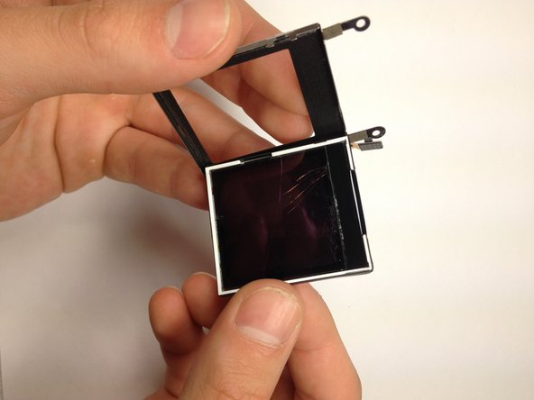

    3. Motorola C168 Screen Replacement: crwdns2935265:08crwdnd2935265:01crwdnd2935265:02crwdne2935265:0 Motorola C168 Screen Replacement: crwdns2935265:08crwdnd2935265:02crwdnd2935265:02crwdne2935265:0
      • Unplug the screen-to-phone interface.
      • Remove the screen from its encasing by pushing it out.
