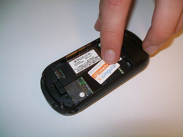

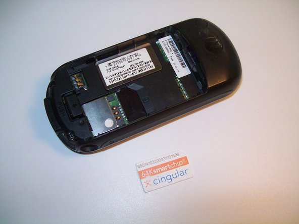

  3. Motorola C139 Speaker Replacement, SIM Card: crwdns2935265:03crwdnd2935265:01crwdnd2935265:03crwdne2935265:0 Motorola C139 Speaker Replacement, SIM Card: crwdns2935265:03crwdnd2935265:02crwdnd2935265:03crwdne2935265:0 Motorola C139 Speaker Replacement, SIM Card: crwdns2935265:03crwdnd2935265:03crwdnd2935265:03crwdne2935265:0
    • Do not bend or scratch the SIM card. In addition, keep it away from static electricity, dust, and water.
    • Gently slide the SIM card out and lift to remove it from the phone.

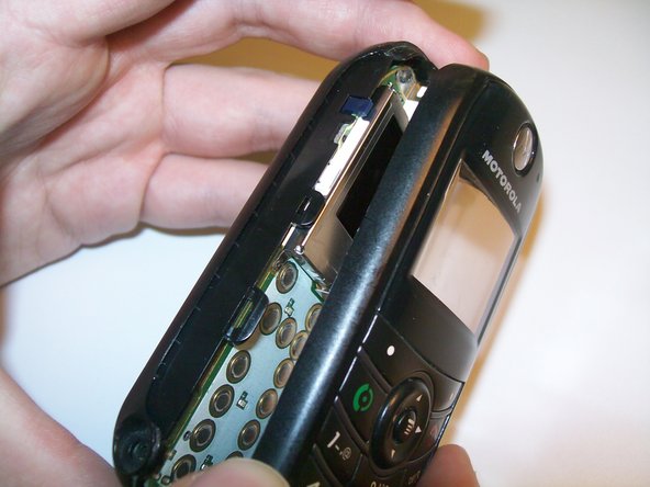

  6. Motorola C139 Speaker Replacement: crwdns2935265:06crwdnd2935265:01crwdnd2935265:03crwdne2935265:0 Motorola C139 Speaker Replacement: crwdns2935265:06crwdnd2935265:02crwdnd2935265:03crwdne2935265:0 Motorola C139 Speaker Replacement: crwdns2935265:06crwdnd2935265:03crwdnd2935265:03crwdne2935265:0
    • Insert the pry tool in the slit on the side of the phone and slide it down until you hear an audible click and the phone bottom loosens from the top.
    • Use the pry tool to release the two hooks on each side and the two hooks at the top holding the case together.
    • Release a total of six hooks from the sides and top to free the phone into two halves.

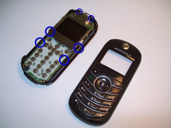

  8. Motorola C139 Speaker Replacement: crwdns2935265:08crwdnd2935265:01crwdnd2935265:03crwdne2935265:0 Motorola C139 Speaker Replacement: crwdns2935265:08crwdnd2935265:02crwdnd2935265:03crwdne2935265:0 Motorola C139 Speaker Replacement: crwdns2935265:08crwdnd2935265:03crwdnd2935265:03crwdne2935265:0
    • Use plastic opening tools to free the circuit board from the case.
    • There are two hooks (one on each side) holding the circuit board into the case.
    • Then grip the circuit board and lift to remove the circuit board from the case.

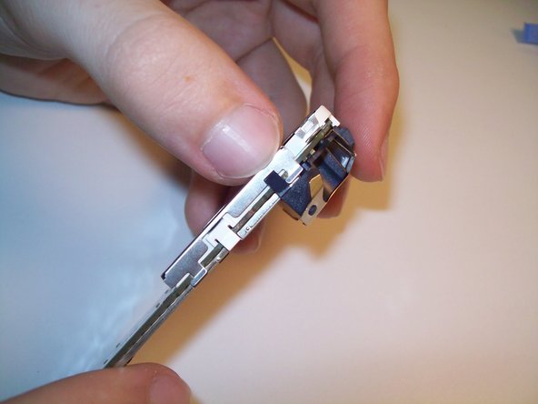

  9. Motorola C139 Speaker Replacement, Antenna: crwdns2935265:09crwdnd2935265:01crwdnd2935265:03crwdne2935265:0 Motorola C139 Speaker Replacement, Antenna: crwdns2935265:09crwdnd2935265:02crwdnd2935265:03crwdne2935265:0 Motorola C139 Speaker Replacement, Antenna: crwdns2935265:09crwdnd2935265:03crwdnd2935265:03crwdne2935265:0
    • Unhook the antenna by releasing the two hooks, one on each side of the phone.
    • Detach the antenna from the back of the circuit board
    • This small black rubber cover may detach.

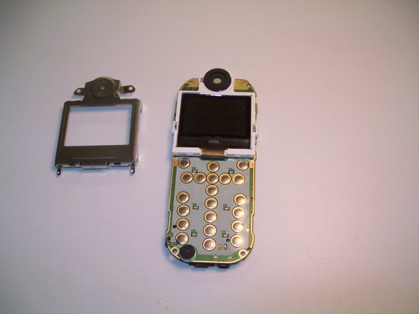

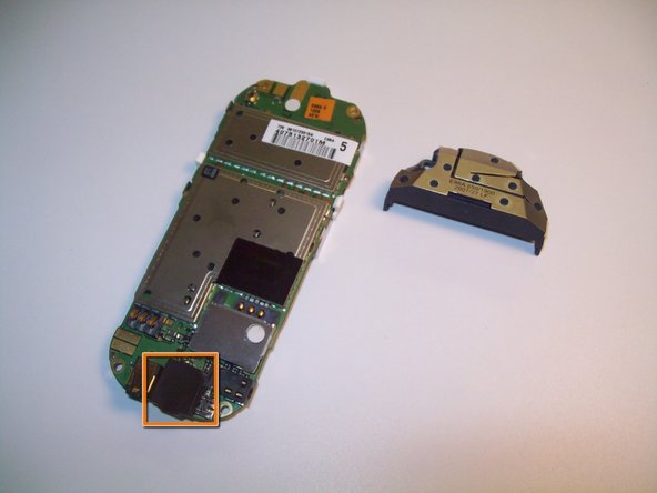

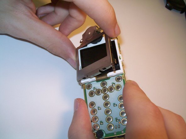

  10. Motorola C139 Speaker Replacement, Speaker: crwdns2935265:010crwdnd2935265:01crwdnd2935265:03crwdne2935265:0 Motorola C139 Speaker Replacement, Speaker: crwdns2935265:010crwdnd2935265:02crwdnd2935265:03crwdne2935265:0 Motorola C139 Speaker Replacement, Speaker: crwdns2935265:010crwdnd2935265:03crwdnd2935265:03crwdne2935265:0
    • Unhook the 10 clips holding the metal screen cover in place and pull up to detach it from the logic board.
    • There are four clips at the top, two along each side, and two clips at the bottom of the metal cover.

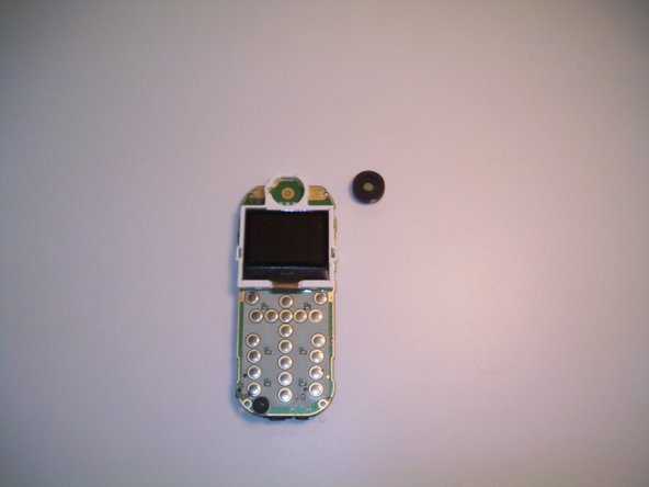

  11. Motorola C139 Speaker Replacement: crwdns2935265:011crwdnd2935265:01crwdnd2935265:02crwdne2935265:0 Motorola C139 Speaker Replacement: crwdns2935265:011crwdnd2935265:02crwdnd2935265:02crwdne2935265:0
    • Lift to remove the speaker from its contact point on the logic board.
