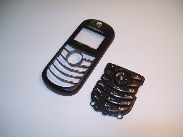

On the top half of the phone push downwards on the number keys to free the keypad from the top of the phone.

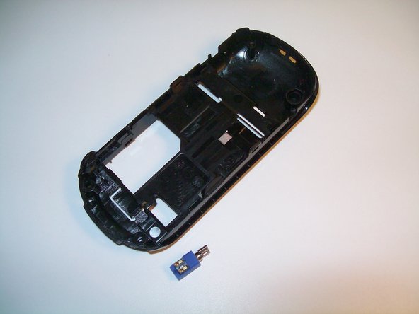

This small black rubber cover may detach.
Using your hands or the pry tool, gently lift the vibration mechanism out of the rear casing.
