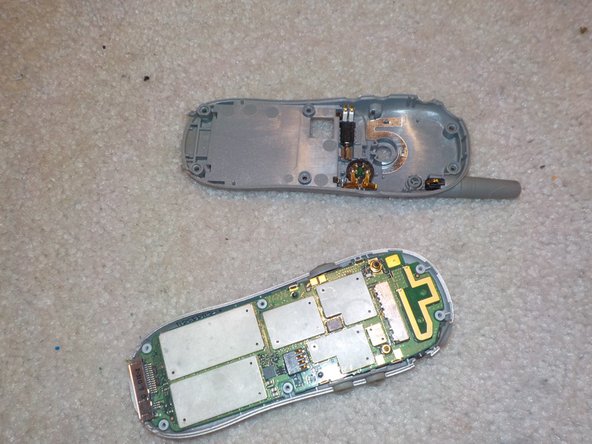

  4. Motorola 120e Teardown, The back panel: crwdns2935265:04crwdnd2935265:01crwdnd2935265:01crwdne2935265:0
    • On the plastic back panel, there is the non-removable antenna, vibrate motor, and speaker. You can use a spudger to remove these.
  5. Motorola 120e Teardown, Logic board and front panel: crwdns2935265:05crwdnd2935265:01crwdnd2935265:01crwdne2935265:0
    • After removing the back, you should now see the board, with the front panel on the other side.

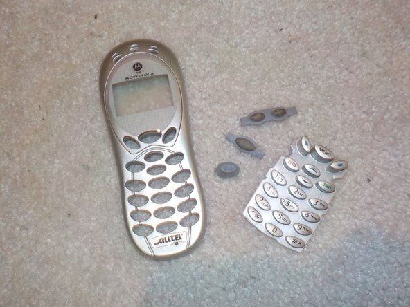

  6. Motorola 120e Teardown, Front panel and buttons: crwdns2935265:06crwdnd2935265:01crwdnd2935265:02crwdne2935265:0 Motorola 120e Teardown, Front panel and buttons: crwdns2935265:06crwdnd2935265:02crwdnd2935265:02crwdne2935265:0
    • The front panel can be lifted off the board, and the rubber buttons can be removed from the front frame.

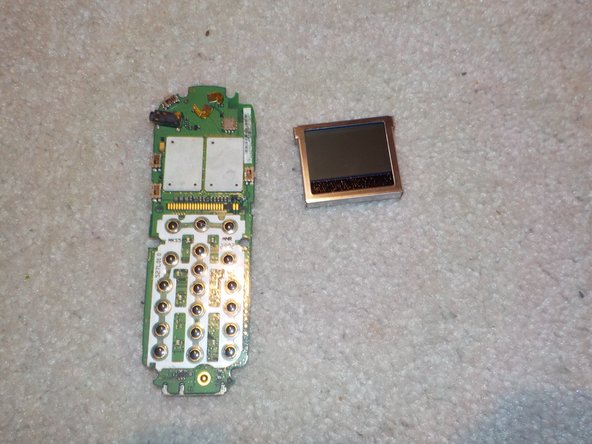

  7. Motorola 120e Teardown, Screen: crwdns2935265:07crwdnd2935265:01crwdnd2935265:02crwdne2935265:0 Motorola 120e Teardown, Screen: crwdns2935265:07crwdnd2935265:02crwdnd2935265:02crwdne2935265:0
    • You can remove the screen by unclipping the 4 clips around the edge of the board and carefully lifting the screen off.
  8. Motorola 120e Teardown, Conclusion: crwdns2935265:08crwdnd2935265:01crwdnd2935265:01crwdne2935265:0
    • Here is all of the parts laid out. To re-assemble, follow the guide in reverse order.
