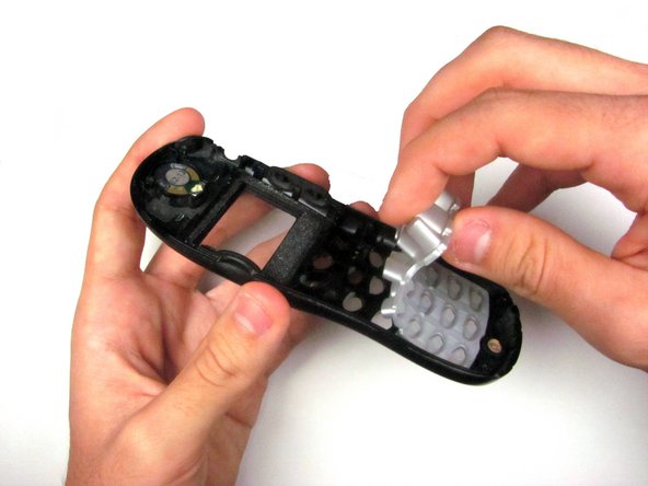

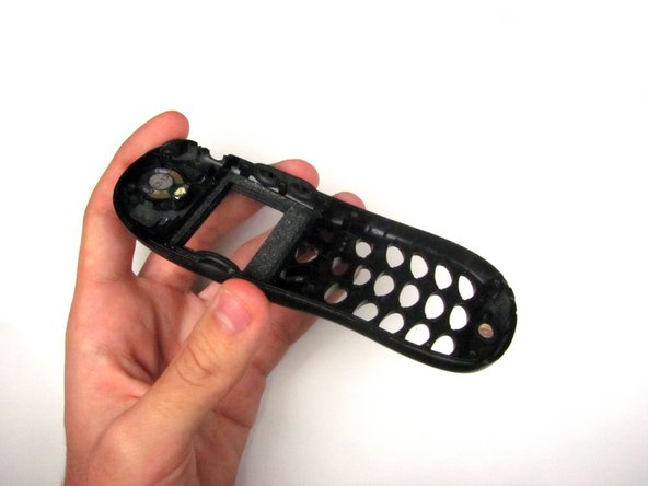

    1. Motorola 120c Keypad Replacement, Keypad: crwdns2935265:05crwdnd2935265:01crwdnd2935265:03crwdne2935265:0 Motorola 120c Keypad Replacement, Keypad: crwdns2935265:05crwdnd2935265:02crwdnd2935265:03crwdne2935265:0 Motorola 120c Keypad Replacement, Keypad: crwdns2935265:05crwdnd2935265:03crwdnd2935265:03crwdne2935265:0
      • Peel the keypad from the front case.
      • The keypad may be stuck either to the logic board, below the screen, or the phone case itself.
