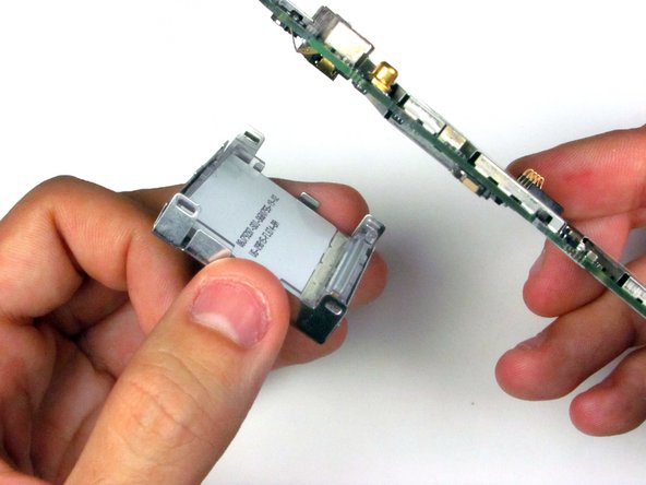

      • Remove the motherboard by lifting it up and out.
    1. Motorola 120c Display Replacement, Display: crwdns2935265:05crwdnd2935265:01crwdnd2935265:01crwdne2935265:0
      • Use tweezers to pry off the four clasps that hold the display in place.
    2. Motorola 120c Display Replacement: crwdns2935265:06crwdnd2935265:01crwdnd2935265:02crwdne2935265:0 Motorola 120c Display Replacement: crwdns2935265:06crwdnd2935265:02crwdnd2935265:02crwdne2935265:0
      • Remove the display.
