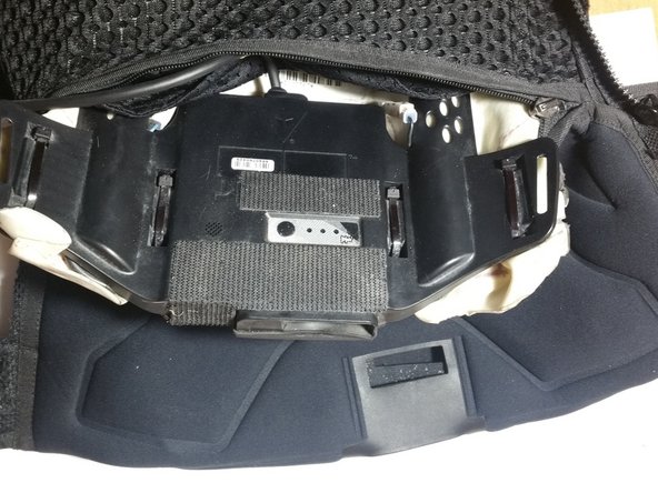

  4. Motorcycle airbag battery replacement Dainese D-Air Street: crwdns2935265:04crwdnd2935265:01crwdnd2935265:02crwdne2935265:0 Motorcycle airbag battery replacement Dainese D-Air Street: crwdns2935265:04crwdnd2935265:02crwdnd2935265:02crwdne2935265:0
    • From the zip you can see the airbag (white) and the part with the battery and circuits (black), held in position with velcro.
    • Operate with caution to not damage the airbag and remove the stiff part from the velcro and extract it.
  5. Motorcycle airbag battery replacement Dainese D-Air Street: crwdns2935265:05crwdnd2935265:01crwdnd2935265:01crwdne2935265:0
    • Turn the stiff part to expose the lid.

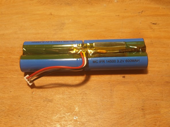

  7. Motorcycle airbag battery replacement Dainese D-Air Street, Disconnect the batteries pack: crwdns2935265:07crwdnd2935265:01crwdnd2935265:02crwdne2935265:0 Motorcycle airbag battery replacement Dainese D-Air Street, Disconnect the batteries pack: crwdns2935265:07crwdnd2935265:02crwdnd2935265:02crwdne2935265:0
    • Disconnect the connector of the batteries and extract them.

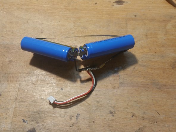

  8. Motorcycle airbag battery replacement Dainese D-Air Street, Detach the circuit: crwdns2935265:08crwdnd2935265:01crwdnd2935265:03crwdne2935265:0 Motorcycle airbag battery replacement Dainese D-Air Street, Detach the circuit: crwdns2935265:08crwdnd2935265:02crwdnd2935265:03crwdne2935265:0 Motorcycle airbag battery replacement Dainese D-Air Street, Detach the circuit: crwdns2935265:08crwdnd2935265:03crwdnd2935265:03crwdne2935265:0
    • The 4 batteries are connected in parallel, along with some components. Carefully detach the circuit soldered to the tabs using for example a blade. Keep the tab that connects the wire and the components intact.

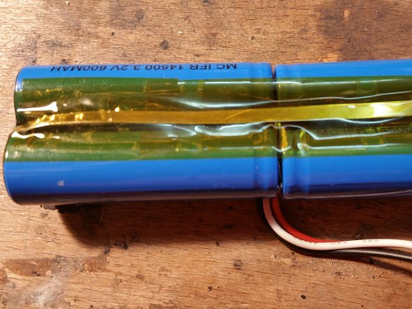

  9. Motorcycle airbag battery replacement Dainese D-Air Street, Assemble new batteries: crwdns2935265:09crwdnd2935265:01crwdnd2935265:01crwdne2935265:0
    • Place the new batteries, paying attention to the polarity. Secure them in position with tape, inserting the ends of the previously separated circuit between the tabs. Be careful not to create a short circuit during the process, as the new batteries may be charged. Reconnect the connector.
