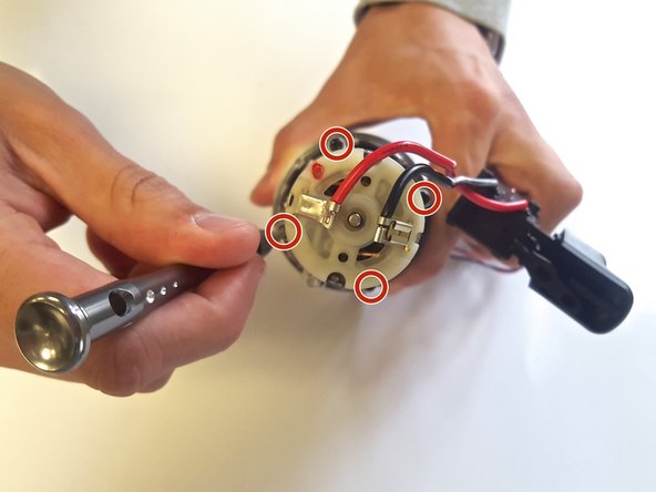

    4. Motor Replacement: crwdns2935265:04crwdnd2935265:01crwdnd2935265:03crwdne2935265:0 Motor Replacement: crwdns2935265:04crwdnd2935265:02crwdnd2935265:03crwdne2935265:0 Motor Replacement: crwdns2935265:04crwdnd2935265:03crwdnd2935265:03crwdne2935265:0
      • Using a phillips head screwdriver, unscrew the four black (9mm) screws located on the plastic attachment at the bottom of the motor.
      • Carefully remove the motor and the plastic attachment from the rest of the drill hardware.
      • Be sure to handle the chuck and remaining drill hardware carefully as gears may fall out of place. Do not turn upside down.

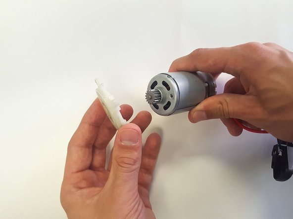

    5. Motor Replacement: crwdns2935265:05crwdnd2935265:01crwdnd2935265:03crwdne2935265:0 Motor Replacement: crwdns2935265:05crwdnd2935265:02crwdnd2935265:03crwdne2935265:0 Motor Replacement: crwdns2935265:05crwdnd2935265:03crwdnd2935265:03crwdne2935265:0

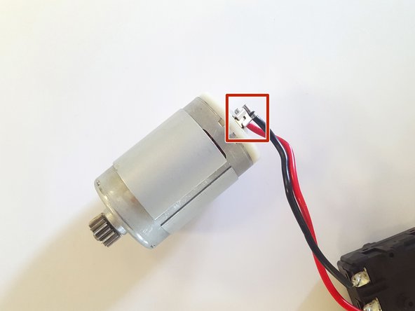

      • Unscrew the plastic attachment from the motor using a phillips head screwdriver. Keep the screws (7mm) after removal.
      • After the screws are removed, detach the plastic attachment from the motor and set aside.
      • Finally, detach the wires from the motor to completely isolate the motor. The wires should wiggle off easily using ESD safe tweezers. It is now successfully removed from the drill and is ready to be replaced.

Any chance you could upload a picture of the motor text without the box going through it, or add the info somewhere? I burnt out the switch and/or transistor in my ss12, so I decided to salvage the motor but the markings on my motor are different even though it looks identical and came from the same drill. I want to use it to build a radial fan for use in an air filter. It would be a huge help in getting the specs (or at least some info) on the motor. Thank you.
