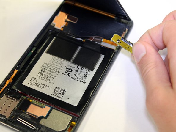

      • Position the opening tool under the lid of the screen.
      • Slide the opening tool around the edge of the screen to loosen the adhesive.
    2. Moto Z Fingerprint Sensor Replacement: crwdns2935265:02crwdnd2935265:01crwdnd2935265:01crwdne2935265:0
      • Lift the screen off the body from the top.
    3. Moto Z Fingerprint Sensor Replacement: crwdns2935265:03crwdnd2935265:01crwdnd2935265:02crwdne2935265:0 Moto Z Fingerprint Sensor Replacement: crwdns2935265:03crwdnd2935265:02crwdnd2935265:02crwdne2935265:0
      • To disconnect the screen from the body, stick the spudger under one of the corners of the gold tab.
      • Lift up, removing the tab from the device.
    4. Moto Z Fingerprint Sensor Replacement: crwdns2935265:04crwdnd2935265:01crwdnd2935265:01crwdne2935265:0
      • Pull the screen up to fully remove it.

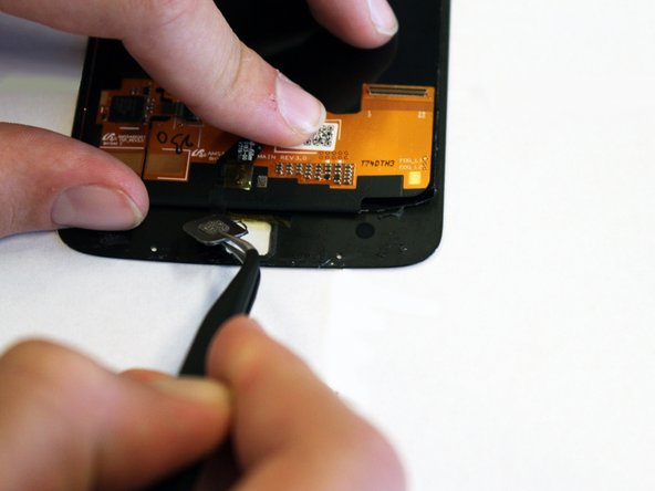

      • Insert the tweezers under the metal backing of the sensor.
      • Lift up the backing until it is detached from the phone.

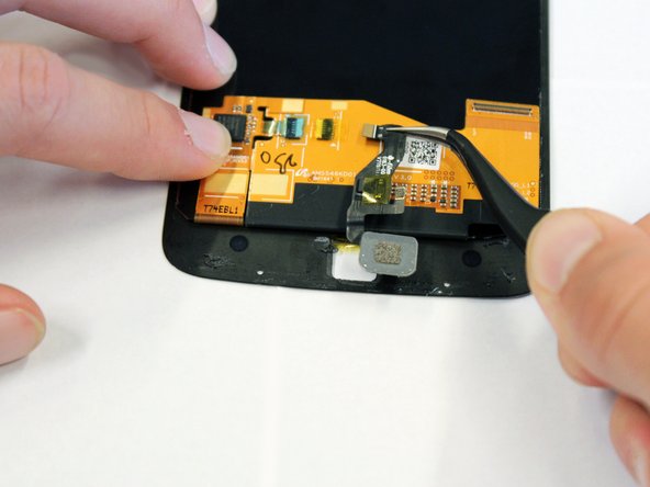

      • With the tweezers, grab the black connector located just above the fingerprint scanner.
      • Pull the connector to the right until it is detached from the phone.
