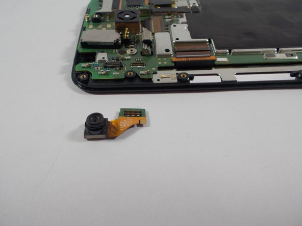

  18. Moto X Pure Edition Front Camera Replacement, Front Camera: crwdns2935265:018crwdnd2935265:01crwdnd2935265:02crwdne2935265:0 Moto X Pure Edition Front Camera Replacement, Front Camera: crwdns2935265:018crwdnd2935265:02crwdnd2935265:02crwdne2935265:0
    • Use the flat end of the nylon spudger to gently pry up on the front camera connector.
