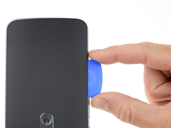

    • Prepare an iOpener and heat the back of the phone along its right edge for about five minutes. This will help soften the adhesive securing the back cover.
    • You may need to reheat and reapply the iOpener several times to get the phone warm enough. Follow the iOpener instructions to avoid overheating.
    • A hair dryer, heat gun, or hot plate may also be used, but be careful not to overheat the phone—the LCD display and internal battery are both susceptible to heat damage.

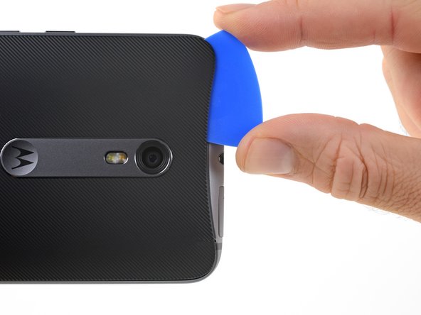

    • Hold a pair of pointed tweezers closed, and insert them into the small hole on the edge of the back cover near the SIM card slot.
    • Use the tweezers to lift the cover up slightly, and slide an opening pick into the gap between the cover and the frame.
  4. Moto X Pure Edition Auxiliary Port Replacement: crwdns2935265:04crwdnd2935265:01crwdnd2935265:03crwdne2935265:0 Moto X Pure Edition Auxiliary Port Replacement: crwdns2935265:04crwdnd2935265:02crwdnd2935265:03crwdne2935265:0 Moto X Pure Edition Auxiliary Port Replacement: crwdns2935265:04crwdnd2935265:03crwdnd2935265:03crwdne2935265:0
    • Slide the opening pick along the edge of the phone to slice through the back cover adhesive.
    • Try to insert the pick as far as you can underneath the cover, toward the center of the cover. There's thick adhesive on the middle of the cover that must be separated.
    • Leave the pick in place as you proceed to the next step. Leaving the pick inserted can help prevent the glue you just separated from re-adhering.

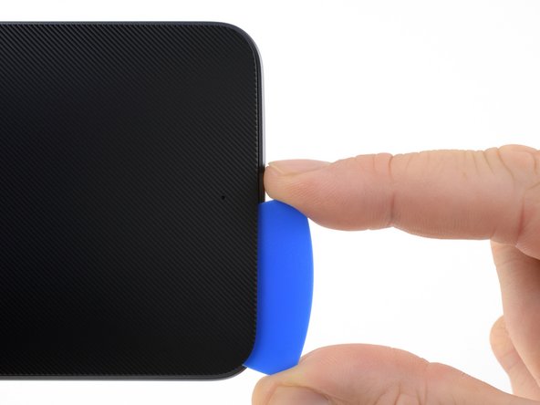

    • Slice through the adhesive along the bottom edge of the phone.
    • Re-heat the back cover as needed to prevent the glue from cooling and hardening.

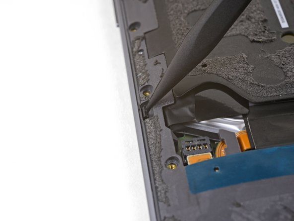

    • Use the point of a spudger to pry up the rubber cover over the battery connector.
    • Remove the rubber cover.

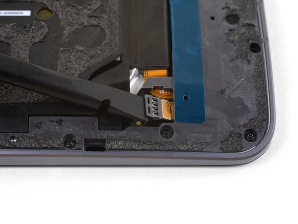

  11. Moto X Pure Edition Auxiliary Port Replacement: crwdns2935265:011crwdnd2935265:01crwdnd2935265:02crwdne2935265:0 Moto X Pure Edition Auxiliary Port Replacement: crwdns2935265:011crwdnd2935265:02crwdnd2935265:02crwdne2935265:0
    • Use the flat end of a spudger to pry the battery connector straight up and out of its socket.
    • Only pry the small tab on the end of the connector opposite the ribbon cable. Do not push against the connector too hard or you risk damaging the plug on the motherboard.

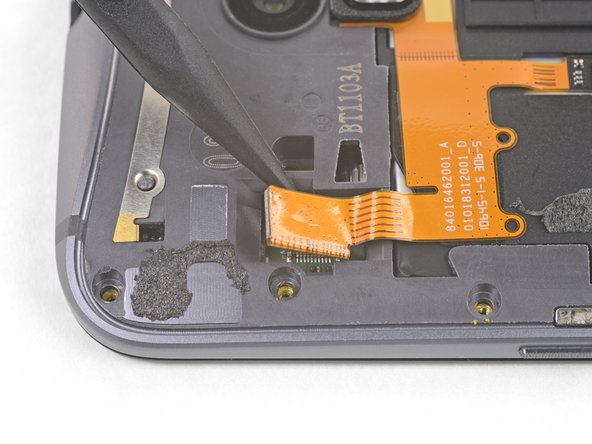

    • Use tweezers to lift away the rubber cover over the flash connector.
  13. Moto X Pure Edition Auxiliary Port Replacement: crwdns2935265:013crwdnd2935265:01crwdnd2935265:02crwdne2935265:0 Moto X Pure Edition Auxiliary Port Replacement: crwdns2935265:013crwdnd2935265:02crwdnd2935265:02crwdne2935265:0
    • Use the tip of a spudger against the corner of the flash connector to pry the connecter straight up and out of its socket.

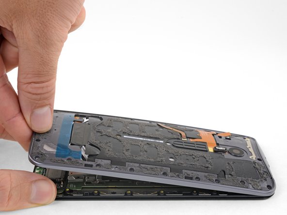

  15. Moto X Pure Edition Auxiliary Port Replacement: crwdns2935265:015crwdnd2935265:01crwdnd2935265:02crwdne2935265:0 Moto X Pure Edition Auxiliary Port Replacement: crwdns2935265:015crwdnd2935265:02crwdnd2935265:02crwdne2935265:0
    • Use the point of a spudger to push the small clip securing the left side of the midframe toward the edge of the phone, releasing the clip.
  16. Moto X Pure Edition Auxiliary Port Replacement: crwdns2935265:016crwdnd2935265:01crwdnd2935265:01crwdne2935265:0
    • Repeat the previous step to release the right side midframe clip.

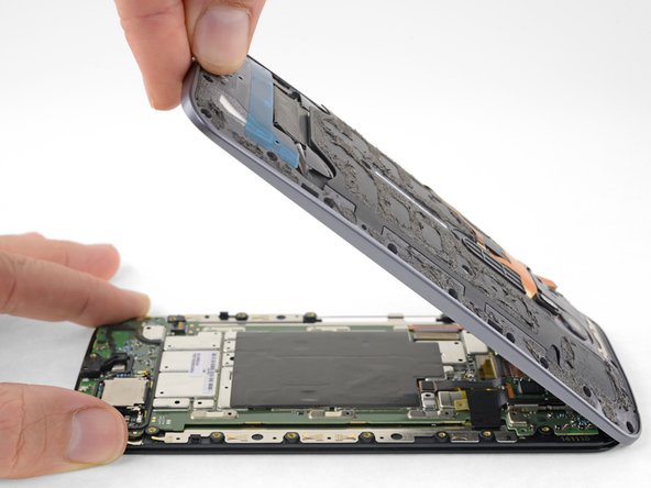

  17. Moto X Pure Edition Auxiliary Port Replacement: crwdns2935265:017crwdnd2935265:01crwdnd2935265:03crwdne2935265:0 Moto X Pure Edition Auxiliary Port Replacement: crwdns2935265:017crwdnd2935265:02crwdnd2935265:03crwdne2935265:0 Moto X Pure Edition Auxiliary Port Replacement: crwdns2935265:017crwdnd2935265:03crwdnd2935265:03crwdne2935265:0
    • Holding the display by the edges, gently lift the midframe away from the display.
    • Remove the midframe from the display.
