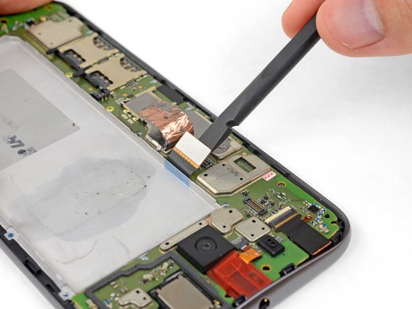

    • Peel up the copper tape covering the display connector.
    • This tape provides protection from electromagnetic interference. Keep it in one piece if possible, and carefully fold it back into position when your repair is complete.
  17. Moto G4 Rear-facing Camera  Replacement: crwdns2935265:017crwdnd2935265:01crwdnd2935265:02crwdne2935265:0 Moto G4 Rear-facing Camera  Replacement: crwdns2935265:017crwdnd2935265:02crwdnd2935265:02crwdne2935265:0
    • Use your spudger to disconnect the display by prying its connector straight up from the motherboard, on the edge nearest the side of the phone.

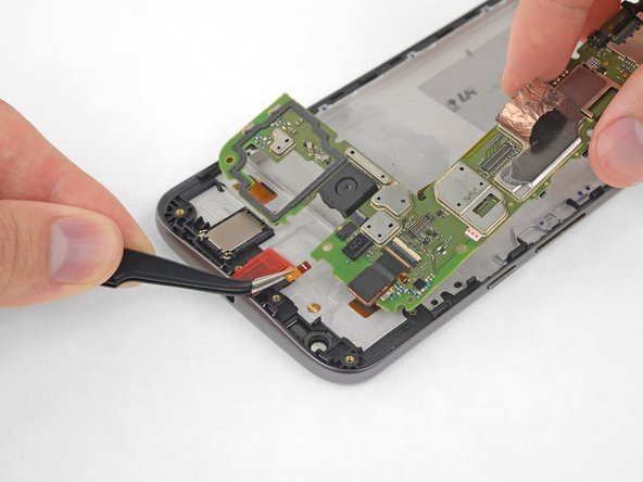

    • Grasping the motherboard by its edges, left the bottom end up at an angle, while keeping the top edge close to the phone.
    • Use your spudger to pry up the front-facing camera and make sure it separates safely from the frame. The camera can remain attached to the motherboard.
    • Using your tweezers, grasp the headphone jack flex cable and carefully pull it out of its socket as you remove the motherboard.
    • Remove the motherboard.
    • If you feel any resistance, stop. Make sure there are no components still holding the frame to the motherboard.
    • If desired, remove the remaining components from the motherboard (cameras and vibration motor).

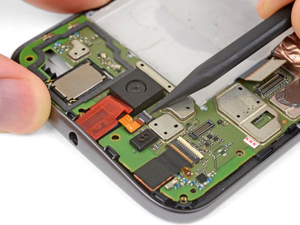

  21. Moto G4 Rear-facing Camera  Replacement, Rear-facing Camera: crwdns2935265:022crwdnd2935265:01crwdnd2935265:01crwdne2935265:0
    • Flip motherboard over to access the rear camera.
    • Peel up orange tape and remove to access the top of rear camera motherboard clamp.
    • Flip up the black tab on the ZIF connector to detach the rear camera.

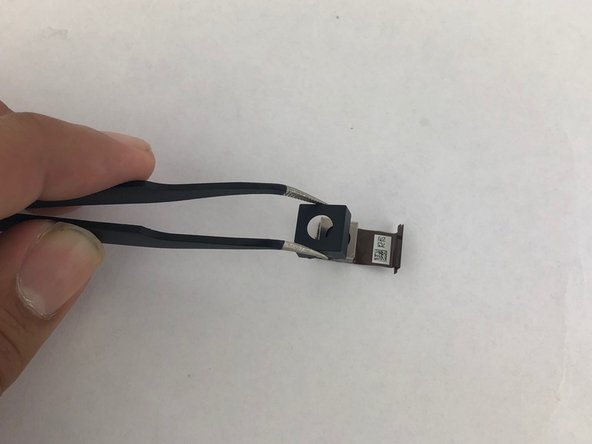

  22. Moto G4 Rear-facing Camera  Replacement: crwdns2935265:023crwdnd2935265:01crwdnd2935265:01crwdne2935265:0
    • Remove rear camera from motherboard.

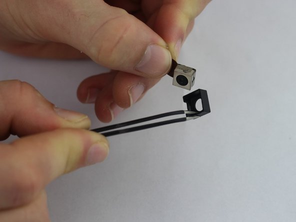

  23. Moto G4 Rear-facing Camera  Replacement: crwdns2935265:024crwdnd2935265:01crwdnd2935265:03crwdne2935265:0 Moto G4 Rear-facing Camera  Replacement: crwdns2935265:024crwdnd2935265:02crwdnd2935265:03crwdne2935265:0 Moto G4 Rear-facing Camera  Replacement: crwdns2935265:024crwdnd2935265:03crwdnd2935265:03crwdne2935265:0
    • Separate the black plastic cover from the broken rear camera you removed.
    • Glue black plastic cover onto the new replacement rear camera.
