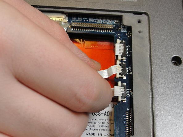

      • To disconnect the three white ribbon cables on the side closest to the hard drive connector, pull the white plastic tabs.
    4. Motion Computing LE1600 Button Assembly Replacement: crwdns2935265:07crwdnd2935265:01crwdnd2935265:01crwdne2935265:0
      • Pull the brown tabs to disconnect the white ribbon cable on the other side.
    5. Motion Computing LE1600 Button Assembly Replacement: crwdns2935265:08crwdnd2935265:01crwdnd2935265:02crwdne2935265:0 Motion Computing LE1600 Button Assembly Replacement: crwdns2935265:08crwdnd2935265:02crwdnd2935265:02crwdne2935265:0
      • Caution: do not pull on the wires, instead pull from the plastic connectors.
      • To disconnect the remaining ribbon cables, pull the plastic connectors away from their connections.
