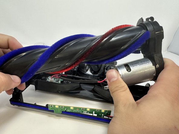

    • Remove the eight 11 mm screws on the bottom of the vacuum with the Phillips #1 screwdriver.
  2. Moosoo XL-618A Floor Brush Replacement: crwdns2935265:02crwdnd2935265:01crwdnd2935265:02crwdne2935265:0 Moosoo XL-618A Floor Brush Replacement: crwdns2935265:02crwdnd2935265:02crwdnd2935265:02crwdne2935265:0
    • Pull the two hard plastic covers off of the floor brush piece.
  3. Moosoo XL-618A Floor Brush Replacement: crwdns2935265:03crwdnd2935265:01crwdnd2935265:02crwdne2935265:0 Moosoo XL-618A Floor Brush Replacement: crwdns2935265:03crwdnd2935265:02crwdnd2935265:02crwdne2935265:0
    • Pull the motor and floor brush attachments out of their slot.
  4. Moosoo XL-618A Floor Brush Replacement: crwdns2935265:04crwdnd2935265:01crwdnd2935265:01crwdne2935265:0
    • Pull the floor brush off of the motor.
