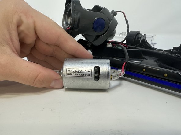

    • Remove the 9 mm screw to the motor with the Phillips #1 screwdriver.

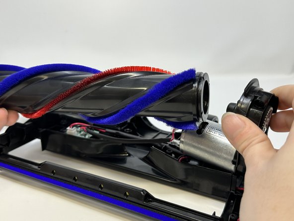

  4. Moosoo XL-618A Belt Replacement: crwdns2935265:04crwdnd2935265:01crwdnd2935265:03crwdne2935265:0 Moosoo XL-618A Belt Replacement: crwdns2935265:04crwdnd2935265:02crwdnd2935265:03crwdne2935265:0 Moosoo XL-618A Belt Replacement: crwdns2935265:04crwdnd2935265:03crwdnd2935265:03crwdne2935265:0
    • Take the motor and floor brush out of their slot and pull the floor brush off of the motor.
    • This is the perfect opportunity to clean the brush as well.
  5. Moosoo XL-618A Belt Replacement: crwdns2935265:05crwdnd2935265:01crwdnd2935265:03crwdne2935265:0 Moosoo XL-618A Belt Replacement: crwdns2935265:05crwdnd2935265:02crwdnd2935265:03crwdne2935265:0 Moosoo XL-618A Belt Replacement: crwdns2935265:05crwdnd2935265:03crwdnd2935265:03crwdne2935265:0
    • Remove the two 9 mm screws with the Phillips #1 screwdriver and pull the plastic piece off of the motor.
