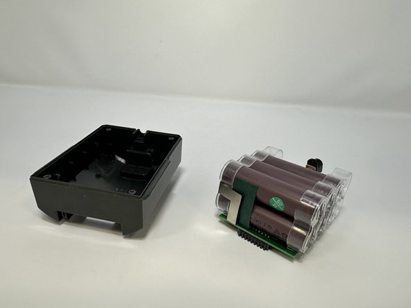

    • Press on the blue tab to release the battery pack, and pull.
  2. Moosoo XL-618A Battery Replacement: crwdns2935265:02crwdnd2935265:01crwdnd2935265:01crwdne2935265:0
    • Remove each 15 mm screw from the four corners of the battery pack using a Phillips #1 screwdriver.
  3. Moosoo XL-618A Battery Replacement: crwdns2935265:03crwdnd2935265:01crwdnd2935265:02crwdne2935265:0 Moosoo XL-618A Battery Replacement: crwdns2935265:03crwdnd2935265:02crwdnd2935265:02crwdne2935265:0
    • Remove the back piece of the battery.
  4. Moosoo XL-618A Battery Replacement: crwdns2935265:04crwdnd2935265:01crwdnd2935265:02crwdne2935265:0 Moosoo XL-618A Battery Replacement: crwdns2935265:04crwdnd2935265:02crwdnd2935265:02crwdne2935265:0
    • Find the wire connecting the battery to the charging port, locate the black tab at the top of the pack and pull the tab out first then the battery.
    • Be careful not to pull the wire out of the battery itself as this will further damage the battery.
