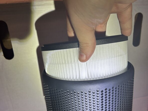

  2. Mooka AP-S0610L Air Filter Replacement: crwdns2935265:02crwdnd2935265:01crwdnd2935265:01crwdne2935265:0
    • Tip the device upside down, so the touch panel is facing the floor and the bottom of the device is facing up.
  3. Mooka AP-S0610L Air Filter Replacement: crwdns2935265:03crwdnd2935265:01crwdnd2935265:01crwdne2935265:0
    • Twist the bottom cover off in a counterclockwise direction.

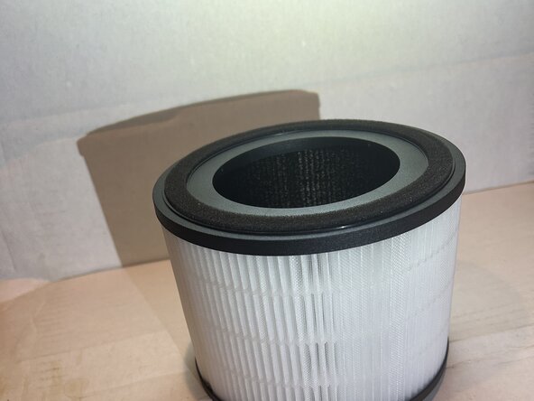

  4. Mooka AP-S0610L Air Filter Replacement, Air Filter: crwdns2935265:04crwdnd2935265:01crwdnd2935265:03crwdne2935265:0 Mooka AP-S0610L Air Filter Replacement, Air Filter: crwdns2935265:04crwdnd2935265:02crwdnd2935265:03crwdne2935265:0 Mooka AP-S0610L Air Filter Replacement, Air Filter: crwdns2935265:04crwdnd2935265:03crwdnd2935265:03crwdne2935265:0
    • Remove the air filter from the device.
