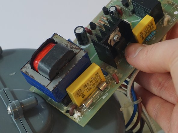

    • An electronic wire is connecting the two PCB’s. Take off the PCB in the lower part of the case by gently pulling the plastic housing, the connection will slowly loosen.
  7. Montiss Air bubble Massage Machine Fuse Replacement: crwdns2935265:07crwdnd2935265:01crwdnd2935265:02crwdne2935265:0 Montiss Air bubble Massage Machine Fuse Replacement: crwdns2935265:07crwdnd2935265:02crwdnd2935265:02crwdne2935265:0
    • Take the PCB out of the case. Here you can see the fuse you want to replace
  8. Montiss Air bubble Massage Machine Fuse Replacement: crwdns2935265:08crwdnd2935265:01crwdnd2935265:03crwdne2935265:0 Montiss Air bubble Massage Machine Fuse Replacement: crwdns2935265:08crwdnd2935265:02crwdnd2935265:03crwdne2935265:0 Montiss Air bubble Massage Machine Fuse Replacement: crwdns2935265:08crwdnd2935265:03crwdnd2935265:03crwdne2935265:0
    • Desolder the two spots connecting the fuse to the PCB. If you have never done this before, use this guide from iFixIt.
  9. Montiss Air bubble Massage Machine Fuse Replacement: crwdns2935265:09crwdnd2935265:01crwdnd2935265:02crwdne2935265:0 Montiss Air bubble Massage Machine Fuse Replacement: crwdns2935265:09crwdnd2935265:02crwdnd2935265:02crwdne2935265:0
    • Take out the fuse with some pliers, since it will be hot because of the soldering.
  10. Montiss Air bubble Massage Machine Fuse Replacement: crwdns2935265:010crwdnd2935265:01crwdnd2935265:02crwdne2935265:0 Montiss Air bubble Massage Machine Fuse Replacement: crwdns2935265:010crwdnd2935265:02crwdnd2935265:02crwdne2935265:0
    • Put in a new fuse and solder it back in place. Now you can reassemble the product.
