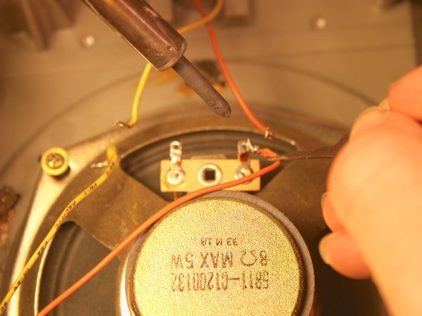

  4. Montgomery Ward GEN-39500 Subwoofer Replacement, Subwoofer: crwdns2935265:04crwdnd2935265:01crwdnd2935265:02crwdne2935265:0 Montgomery Ward GEN-39500 Subwoofer Replacement, Subwoofer: crwdns2935265:04crwdnd2935265:02crwdnd2935265:02crwdne2935265:0
    • Unsolder the wires leading to and from the subwoofer.
  5. Montgomery Ward GEN-39500 Subwoofer Replacement: crwdns2935265:05crwdnd2935265:01crwdnd2935265:01crwdne2935265:0
    • Unscrew the four 12.5 mm Phillips screws holding the subwoofer in place.
    • One of the screws holds down a metal cable organizer. For better cable organization after reassembly keep track of this organizer.
  6. Montgomery Ward GEN-39500 Subwoofer Replacement: crwdns2935265:06crwdnd2935265:01crwdnd2935265:01crwdne2935265:0
    • Remove the subwoofer.
    • The process is the same for both sides.
