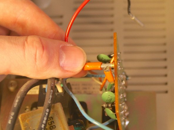

    • Unplug the black and yellow wires connecting the power supply unit to the rest of the electronics:
    • This is not necessarily required. This step is to allow the back cover more movement as you work on the inside of the unit.

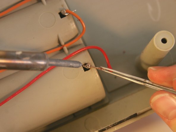

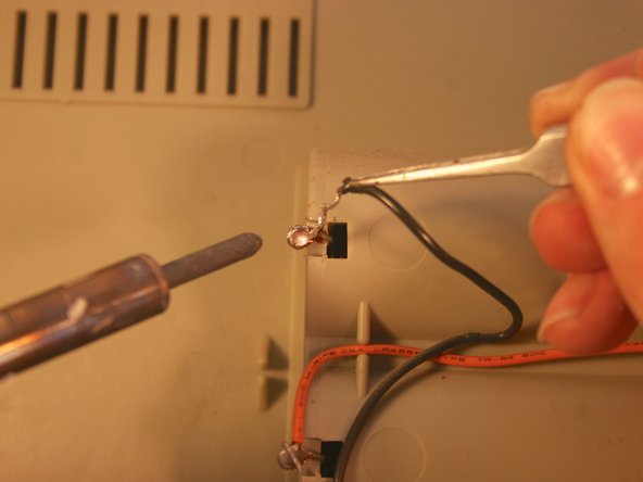

    • Unsolder the wires connecting the power supply unit to the battery container.
