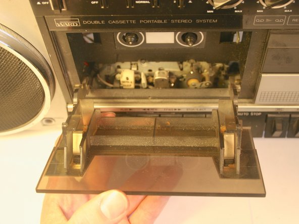

    • Stand the unit up and press eject to open the door on the cassette player.
    • Gripping the cassette player from the back, lift upwards on the door to unclip it from the bar around which it rotates. This may take some effort.

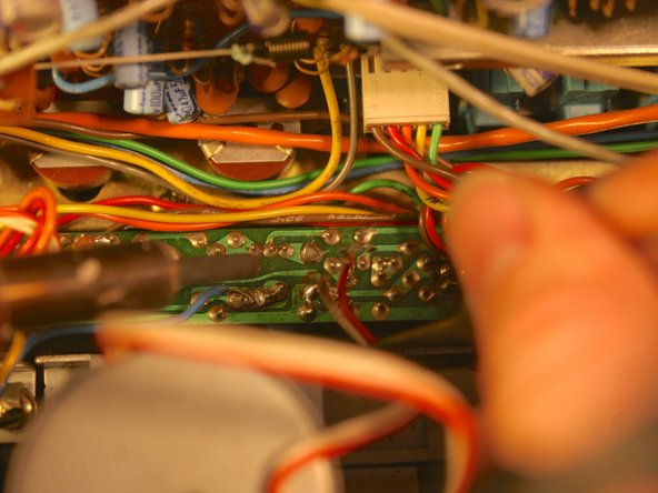

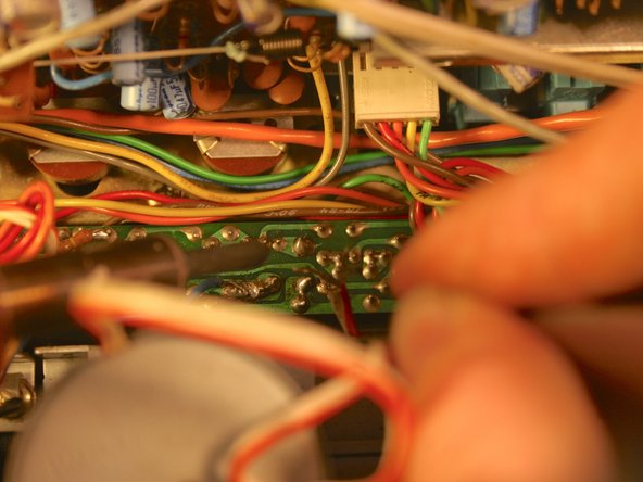

    • Unsolder the red and white wires leading from the cassette player unit.

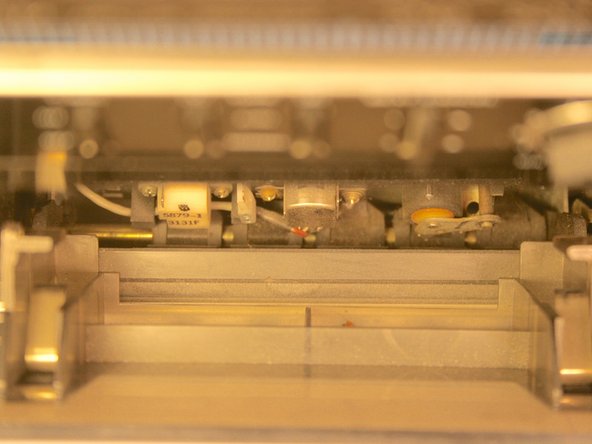

    • Unplug the grey wire leading from the cassette player.
  11. Montgomery Ward GEN-39500 Cassette Player Replacement (Left Side): crwdns2935265:011crwdnd2935265:01crwdnd2935265:01crwdne2935265:0
    • Remove the cassette player.
