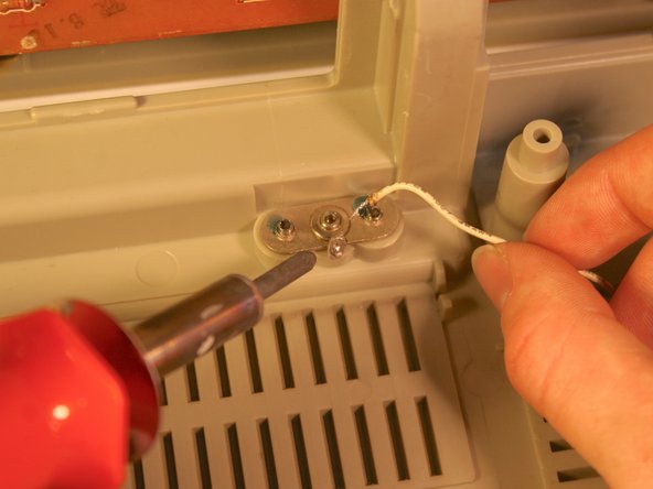

  4. Montgomery Ward GEN-39500 Antenna Replacement, Antenna: crwdns2935265:04crwdnd2935265:01crwdnd2935265:02crwdne2935265:0 Montgomery Ward GEN-39500 Antenna Replacement, Antenna: crwdns2935265:04crwdnd2935265:02crwdnd2935265:02crwdne2935265:0
    • Unsolder the wire connecting the antenna to the radio.
  5. Montgomery Ward GEN-39500 Antenna Replacement: crwdns2935265:05crwdnd2935265:01crwdnd2935265:01crwdne2935265:0
    • Tilt the back cover up and remove the two 7.5 mm Phillips screws holding the antenna in place.
  6. Montgomery Ward GEN-39500 Antenna Replacement: crwdns2935265:06crwdnd2935265:01crwdnd2935265:01crwdne2935265:0
    • Remove the antenna.
