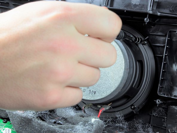

  16. Monster Soundstage S2 Rear Speaker Replacement, Rear Speaker: crwdns2935265:016crwdnd2935265:01crwdnd2935265:02crwdne2935265:0 Monster Soundstage S2 Rear Speaker Replacement, Rear Speaker: crwdns2935265:016crwdnd2935265:02crwdnd2935265:02crwdne2935265:0
    • Remove the four 10mm screws that secure the rear speaker with a TR 10 driver.
    • Remove the rear speaker from the housing.
    • Be careful to not stress or damage the two wires that are connected to the driver.
  17. Monster Soundstage S2 Rear Speaker Replacement: crwdns2935265:017crwdnd2935265:01crwdnd2935265:01crwdne2935265:0
    • Carefully but firmly unplug the two wires from the driver.
    • Remove the rear speaker.
