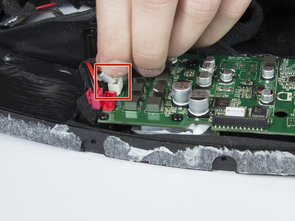

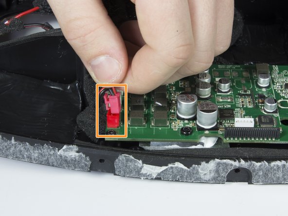

  16. Monster Soundstage S2 Logic Board Replacement, Logic Board: crwdns2935265:016crwdnd2935265:01crwdnd2935265:03crwdne2935265:0 Monster Soundstage S2 Logic Board Replacement, Logic Board: crwdns2935265:016crwdnd2935265:02crwdnd2935265:03crwdne2935265:0 Monster Soundstage S2 Logic Board Replacement, Logic Board: crwdns2935265:016crwdnd2935265:03crwdnd2935265:03crwdne2935265:0
    • Unplug the rear white connector from the logic board.
    • Unplug the rear red connector beside the white one.

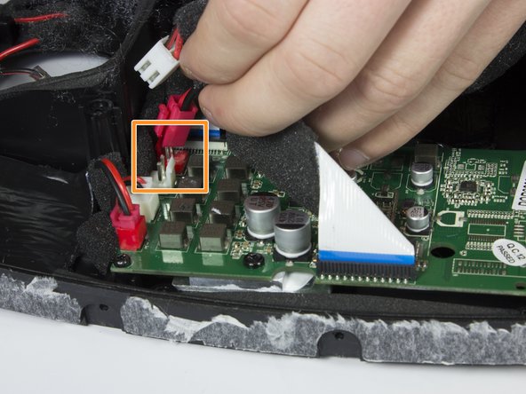

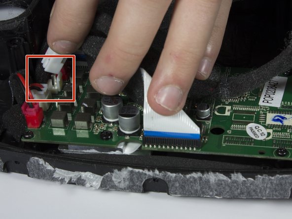

  17. Monster Soundstage S2 Logic Board Replacement: crwdns2935265:017crwdnd2935265:01crwdnd2935265:03crwdne2935265:0 Monster Soundstage S2 Logic Board Replacement: crwdns2935265:017crwdnd2935265:02crwdnd2935265:03crwdne2935265:0 Monster Soundstage S2 Logic Board Replacement: crwdns2935265:017crwdnd2935265:03crwdnd2935265:03crwdne2935265:0
    • Unplug the front white connector from the logic board.

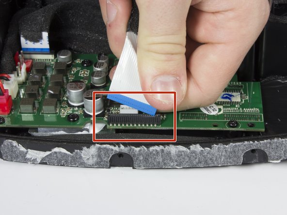

  18. Monster Soundstage S2 Logic Board Replacement: crwdns2935265:018crwdnd2935265:01crwdnd2935265:02crwdne2935265:0 Monster Soundstage S2 Logic Board Replacement: crwdns2935265:018crwdnd2935265:02crwdnd2935265:02crwdne2935265:0
    • Remove the front ribbon cable from the logic board.
    • There is no retention mechanism on this connector.

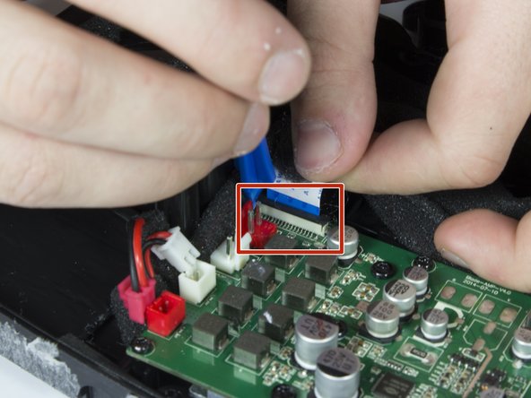

  19. Monster Soundstage S2 Logic Board Replacement: crwdns2935265:019crwdnd2935265:01crwdnd2935265:02crwdne2935265:0 Monster Soundstage S2 Logic Board Replacement: crwdns2935265:019crwdnd2935265:02crwdnd2935265:02crwdne2935265:0
    • Use a plastic opening tool to lift the brown ribbon cable retainer clip.
    • The ribbon cable can now be removed from the logic board.
