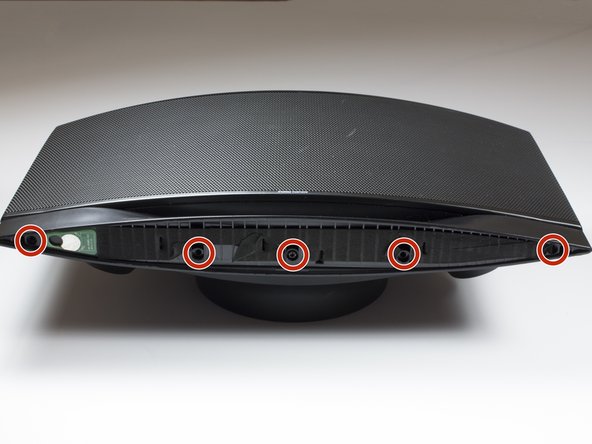

    • Use a spudger or your fingers to pry off and remove the rubber pad on the bottom of the speaker.
  2. Monster Soundstage S2 Front Panel Replacement: crwdns2935265:02crwdnd2935265:01crwdnd2935265:03crwdne2935265:0 Monster Soundstage S2 Front Panel Replacement: crwdns2935265:02crwdnd2935265:02crwdnd2935265:03crwdne2935265:0 Monster Soundstage S2 Front Panel Replacement: crwdns2935265:02crwdnd2935265:03crwdnd2935265:03crwdne2935265:0
    • Remove the five 10mm screws with a TR 10 screwdriver.
    • Use a spudger to break the remaining adhesive holding the grille to the speaker body.
    • Be sure you don't bend the grille; it is not free from the speaker yet.

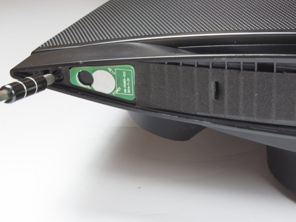

    • Flip speaker around and use a plastic opening tool to remove the top panel from the speaker.

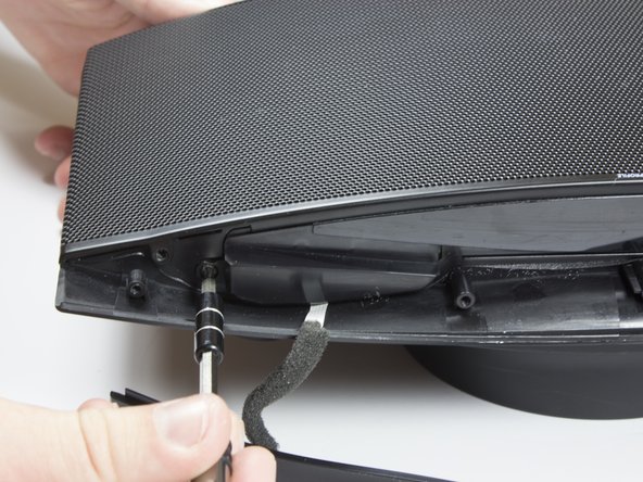

  4. Monster Soundstage S2 Front Panel Replacement: crwdns2935265:04crwdnd2935265:01crwdnd2935265:03crwdne2935265:0 Monster Soundstage S2 Front Panel Replacement: crwdns2935265:04crwdnd2935265:02crwdnd2935265:03crwdne2935265:0 Monster Soundstage S2 Front Panel Replacement: crwdns2935265:04crwdnd2935265:03crwdnd2935265:03crwdne2935265:0
    • Use a plastic opening tool to remove the foam and uncover four more screws.
    • Use a TR 10 screwdriver to remove the five 10mm screws on the top of the speaker.

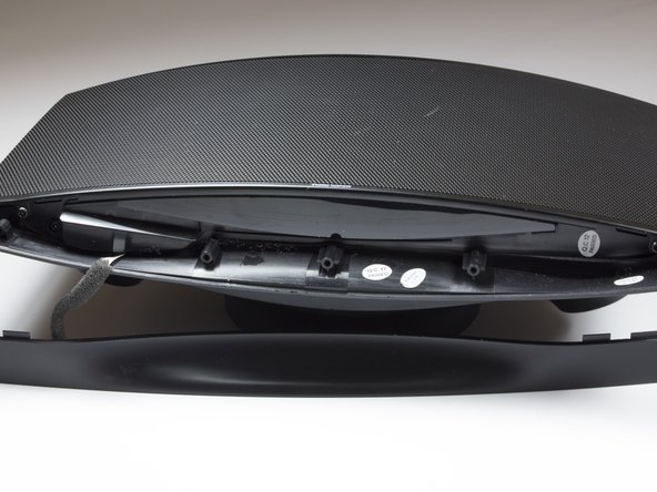

  5. Monster Soundstage S2 Front Panel Replacement: crwdns2935265:05crwdnd2935265:01crwdnd2935265:02crwdne2935265:0 Monster Soundstage S2 Front Panel Replacement: crwdns2935265:05crwdnd2935265:02crwdnd2935265:02crwdne2935265:0
    • Carefully remove the top cover.
    • Be careful not to tear or stress the cable that provides power to the power LED.

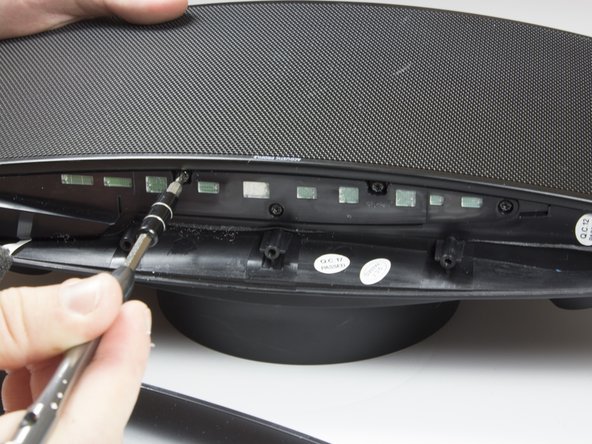

  6. Monster Soundstage S2 Front Panel Replacement: crwdns2935265:06crwdnd2935265:01crwdnd2935265:02crwdne2935265:0 Monster Soundstage S2 Front Panel Replacement: crwdns2935265:06crwdnd2935265:02crwdnd2935265:02crwdne2935265:0
    • Use a TR 10 screwdriver to remove two of the 10mm screws that secure the speaker grille.
    • Do not attempt to remove the grille just yet.

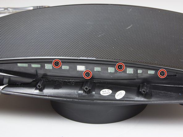

  7. Monster Soundstage S2 Front Panel Replacement: crwdns2935265:07crwdnd2935265:01crwdnd2935265:03crwdne2935265:0 Monster Soundstage S2 Front Panel Replacement: crwdns2935265:07crwdnd2935265:02crwdnd2935265:03crwdne2935265:0 Monster Soundstage S2 Front Panel Replacement: crwdns2935265:07crwdnd2935265:03crwdnd2935265:03crwdne2935265:0
    • With the top panel removed, use a spudger to remove the display panel.
    • The clips on the display panel are quite fragile. Pry up both edges of the display before attempting removal.
    • Use a TR 10 screwdriver to remove the four final 10mm screws securing the speaker grille.

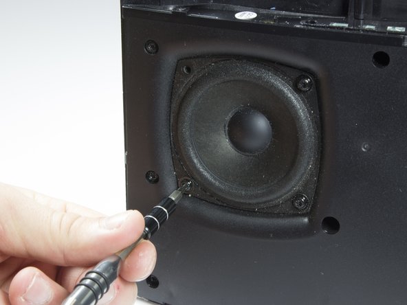

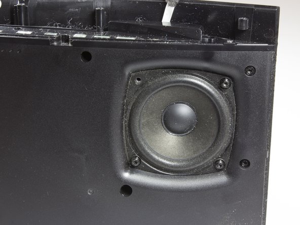

  9. Monster Soundstage S2 Front Panel Replacement, Front Speakers: crwdns2935265:09crwdnd2935265:01crwdnd2935265:03crwdne2935265:0 Monster Soundstage S2 Front Panel Replacement, Front Speakers: crwdns2935265:09crwdnd2935265:02crwdnd2935265:03crwdne2935265:0 Monster Soundstage S2 Front Panel Replacement, Front Speakers: crwdns2935265:09crwdnd2935265:03crwdnd2935265:03crwdne2935265:0
    • After removing grille, you will see the speakers.
    • Remove the eight 10mm screws that surround the speakers. There will be four around each speaker.

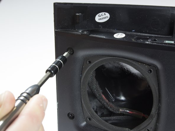

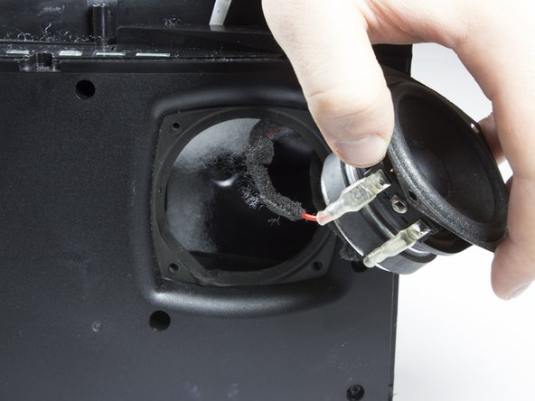

  10. Monster Soundstage S2 Front Panel Replacement: crwdns2935265:010crwdnd2935265:01crwdnd2935265:02crwdne2935265:0 Monster Soundstage S2 Front Panel Replacement: crwdns2935265:010crwdnd2935265:02crwdnd2935265:02crwdne2935265:0
    • Carefully lift each speaker from the housing. It may be necessary to break a light adhesive seal.
    • Be aware of the two wires that are connected to each speaker.
    • Set each speaker beside the main housing.

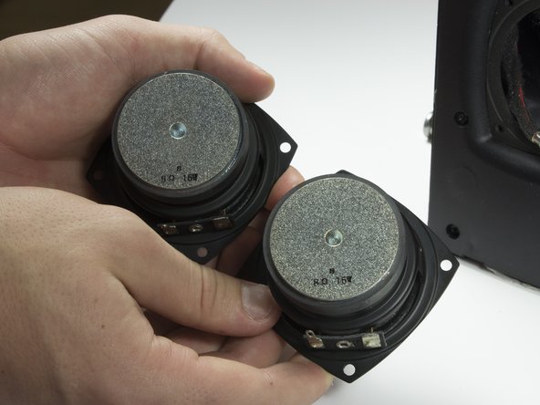

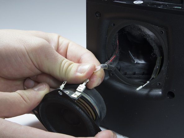

  11. Monster Soundstage S2 Front Panel Replacement: crwdns2935265:011crwdnd2935265:01crwdnd2935265:03crwdne2935265:0 Monster Soundstage S2 Front Panel Replacement: crwdns2935265:011crwdnd2935265:02crwdnd2935265:03crwdne2935265:0 Monster Soundstage S2 Front Panel Replacement: crwdns2935265:011crwdnd2935265:03crwdnd2935265:03crwdne2935265:0
    • Carefully but firmly unplug the two wires from each driver.
    • The front speakers can now be removed.

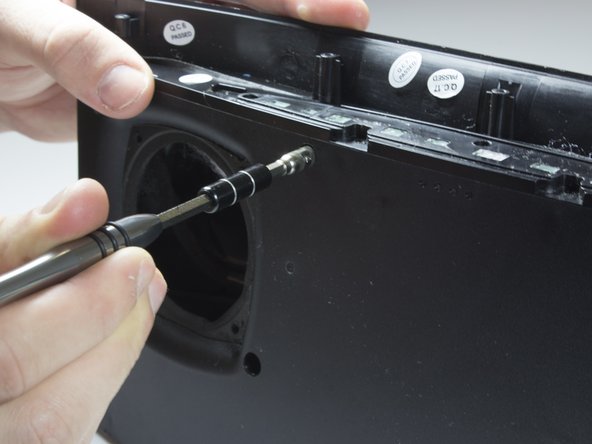

  12. Monster Soundstage S2 Front Panel Replacement, Front Panel: crwdns2935265:012crwdnd2935265:01crwdnd2935265:02crwdne2935265:0 Monster Soundstage S2 Front Panel Replacement, Front Panel: crwdns2935265:012crwdnd2935265:02crwdnd2935265:02crwdne2935265:0
    • Identify the eight screws around the border of the front panel.
    • Using the TR 10 driver, remove the two 8mm screws.
    • Using the TR 10 driver, remove the six 12mm screws.

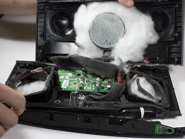

  15. Monster Soundstage S2 Front Panel Replacement: crwdns2935265:015crwdnd2935265:01crwdnd2935265:02crwdne2935265:0 Monster Soundstage S2 Front Panel Replacement: crwdns2935265:015crwdnd2935265:02crwdnd2935265:02crwdne2935265:0
    • Gently pull the front panel away from the back panel.
    • There are wires that connect the front and back panels. The two sides can be safely folded away from each other and laid flat on the table.
    • Remove the white sound dampening material from the speaker. Note the location of the material and set aside.
