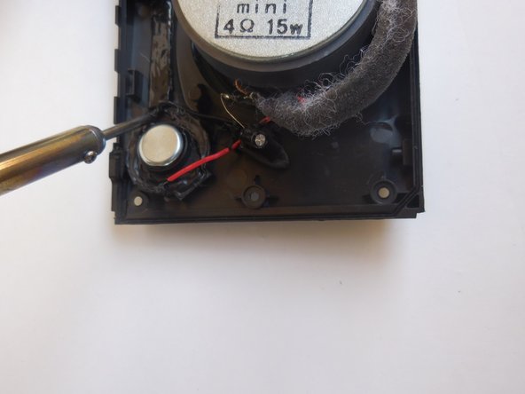

  3. Monster SoundStage S1 Mini Speaker Replacement: crwdns2935265:03crwdnd2935265:01crwdnd2935265:01crwdne2935265:0
    • Remove the black putty from the speaker wires at both ends of the speaker board.

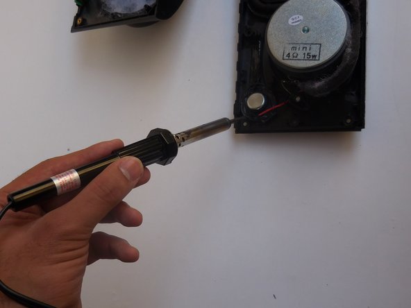

  4. Monster SoundStage S1 Mini Speaker Replacement: crwdns2935265:04crwdnd2935265:01crwdnd2935265:03crwdne2935265:0 Monster SoundStage S1 Mini Speaker Replacement: crwdns2935265:04crwdnd2935265:02crwdnd2935265:03crwdne2935265:0 Monster SoundStage S1 Mini Speaker Replacement: crwdns2935265:04crwdnd2935265:03crwdnd2935265:03crwdne2935265:0
    • Solder the black plastic encasing the red and black wires.

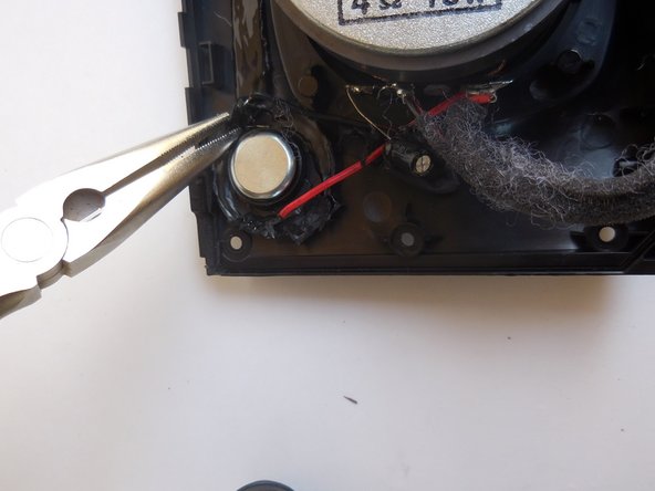

  5. Monster SoundStage S1 Mini Speaker Replacement: crwdns2935265:05crwdnd2935265:01crwdnd2935265:02crwdne2935265:0 Monster SoundStage S1 Mini Speaker Replacement: crwdns2935265:05crwdnd2935265:02crwdnd2935265:02crwdne2935265:0
    • Remove both the black and red wires with pliers
    • Pliers may stick to speaker because it is magnetic.

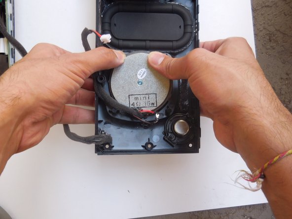

  6. Monster SoundStage S1 Mini Speaker Replacement: crwdns2935265:06crwdnd2935265:01crwdnd2935265:02crwdne2935265:0 Monster SoundStage S1 Mini Speaker Replacement: crwdns2935265:06crwdnd2935265:02crwdnd2935265:02crwdne2935265:0
    • Tuck wires through the hole where the speaker is located, then gently push the speaker out.
    • The 1.2 cm Torx security screws that stayed in place near the speaker will now fall out.
    • To remove the other speaker repeat steps 3-6
