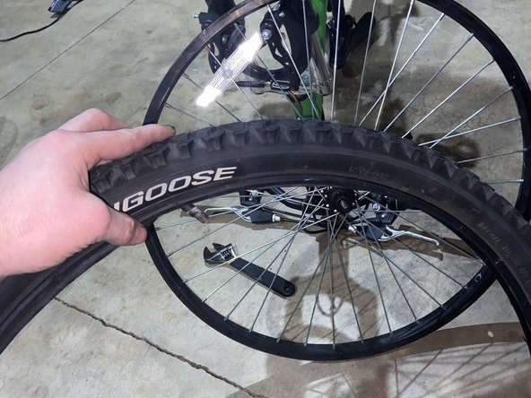

    • With the 8" Pittsburgh wrench remove the nuts that hold the wheel and the hub together. Turn the wrench counterclockwise to unscrew the nuts.
  2. Mongoose 24” Front Tire Replacement: crwdns2935265:02crwdnd2935265:01crwdnd2935265:01crwdne2935265:0
    • With your hands, remove the tire from the hub.
  3. Mongoose 24” Front Tire Replacement: crwdns2935265:03crwdnd2935265:01crwdnd2935265:02crwdne2935265:0 Mongoose 24” Front Tire Replacement: crwdns2935265:03crwdnd2935265:02crwdnd2935265:02crwdne2935265:0
    • Before removing the tire from the rim. Unscrew the air nuzzle cap so that it can go through the rim hole.
    • To unscrew the nuzzle cap, turn the cap counterclockwise.
  4. Mongoose 24” Front Tire Replacement: crwdns2935265:04crwdnd2935265:01crwdnd2935265:02crwdne2935265:0 Mongoose 24” Front Tire Replacement: crwdns2935265:04crwdnd2935265:02crwdnd2935265:02crwdne2935265:0
    • From the side where the air nuzzle is at, begin separating the tire from the rim by folding the tire so that you can pop it out of the rim.
  5. Mongoose 24” Front Tire Replacement: crwdns2935265:05crwdnd2935265:01crwdnd2935265:03crwdne2935265:0 Mongoose 24” Front Tire Replacement: crwdns2935265:05crwdnd2935265:02crwdnd2935265:03crwdne2935265:0 Mongoose 24” Front Tire Replacement: crwdns2935265:05crwdnd2935265:03crwdnd2935265:03crwdne2935265:0
    • Remove the damaged inner tube from the inside of the tire.
  6. Mongoose 24” Front Tire Replacement: crwdns2935265:06crwdnd2935265:01crwdnd2935265:02crwdne2935265:0 Mongoose 24” Front Tire Replacement: crwdns2935265:06crwdnd2935265:02crwdnd2935265:02crwdne2935265:0
    • Insert the new 24"inner tube in the tire crease.
    • Make sure the new inner tube is sitting comfortably inside the tire.
  7. Mongoose 24” Front Tire Replacement: crwdns2935265:07crwdnd2935265:01crwdnd2935265:01crwdne2935265:0
    • Insert the air nuzzle through the rim hole and then attach the tire to the rim by folding the tire into the rim.
  8. Mongoose 24” Front Tire Replacement: crwdns2935265:08crwdnd2935265:01crwdnd2935265:01crwdne2935265:0
    • Grab the tire and place it on the hub of the bike.
  9. Mongoose 24” Front Tire Replacement: crwdns2935265:09crwdnd2935265:01crwdnd2935265:01crwdne2935265:0
    • With the 8" Pittsburgh wrench screw the nuts back into place.
    • Turn the screw clock wise to tighten the screw.
    • Make sure the screws are tight so that the tire does not fall out mid bike ride.
