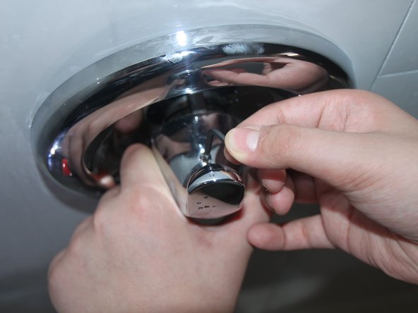

  4. Moen Posi-Temp Cartridge Part #1112b Replacement: crwdns2935265:04crwdnd2935265:01crwdnd2935265:02crwdne2935265:0 Moen Posi-Temp Cartridge Part #1112b Replacement: crwdns2935265:04crwdnd2935265:02crwdnd2935265:02crwdne2935265:0

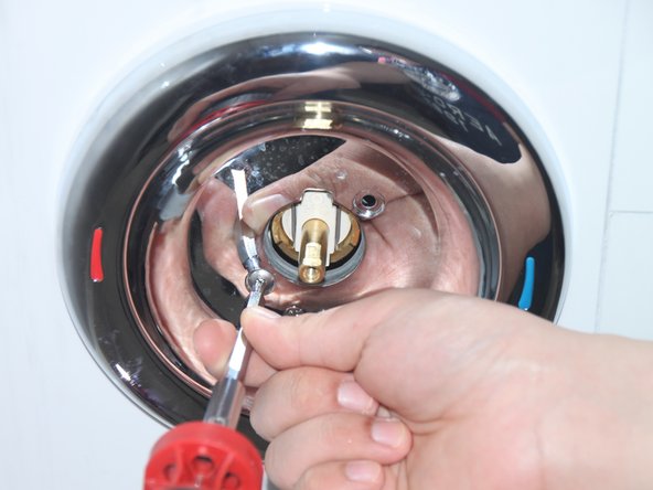

    • Unscrew the handle screw with an Allen wrench.
    • Remove the handle.
  5. Moen Posi-Temp Cartridge Part #1112b Replacement: crwdns2935265:05crwdnd2935265:01crwdnd2935265:02crwdne2935265:0 Moen Posi-Temp Cartridge Part #1112b Replacement: crwdns2935265:05crwdnd2935265:02crwdnd2935265:02crwdne2935265:0
    • Remove the handle adaptor screw with a Phillips screwdriver.
    • Remove the handle adaptor simply by pulling it out.

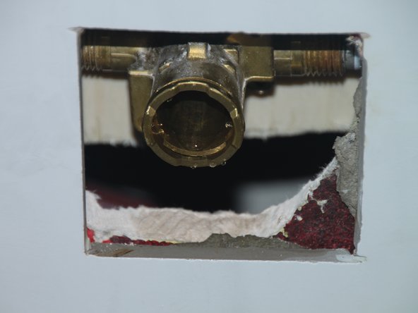

  6. Moen Posi-Temp Cartridge Part #1112b Replacement: crwdns2935265:06crwdnd2935265:01crwdnd2935265:01crwdne2935265:0
    • Pull out the white key/adjustable limit stop.

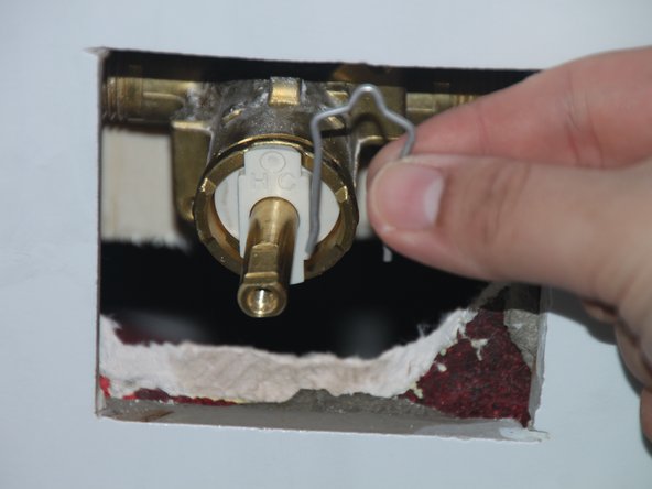

  7. Moen Posi-Temp Cartridge Part #1112b Replacement: crwdns2935265:07crwdnd2935265:01crwdnd2935265:03crwdne2935265:0 Moen Posi-Temp Cartridge Part #1112b Replacement: crwdns2935265:07crwdnd2935265:02crwdnd2935265:03crwdne2935265:0 Moen Posi-Temp Cartridge Part #1112b Replacement: crwdns2935265:07crwdnd2935265:03crwdnd2935265:03crwdne2935265:0
    • Gently pull out the stop tube.
  8. Moen Posi-Temp Cartridge Part #1112b Replacement: crwdns2935265:08crwdnd2935265:01crwdnd2935265:03crwdne2935265:0 Moen Posi-Temp Cartridge Part #1112b Replacement: crwdns2935265:08crwdnd2935265:02crwdnd2935265:03crwdne2935265:0 Moen Posi-Temp Cartridge Part #1112b Replacement: crwdns2935265:08crwdnd2935265:03crwdnd2935265:03crwdne2935265:0

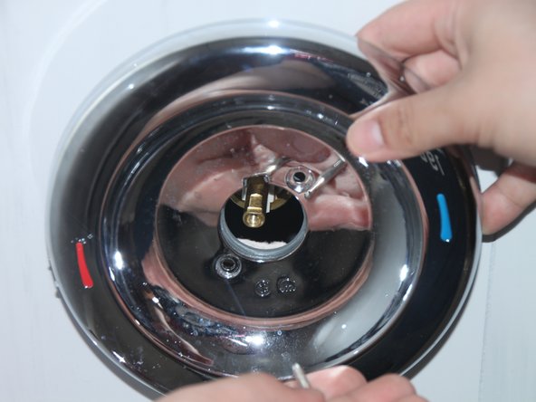

    • Using the Phillips head screwdriver, remove the two screws located at the top right corner and bottom left corner.
    • Remove the metal plate.

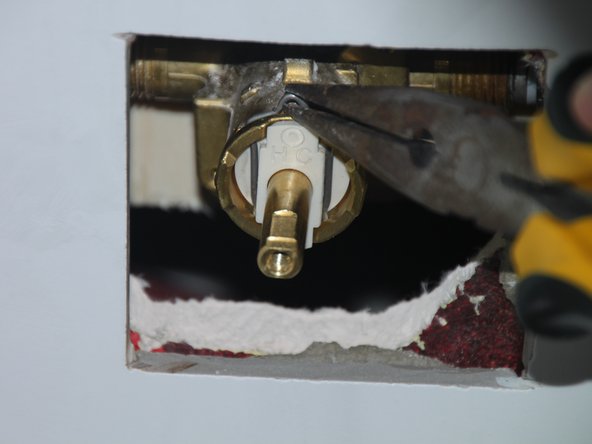

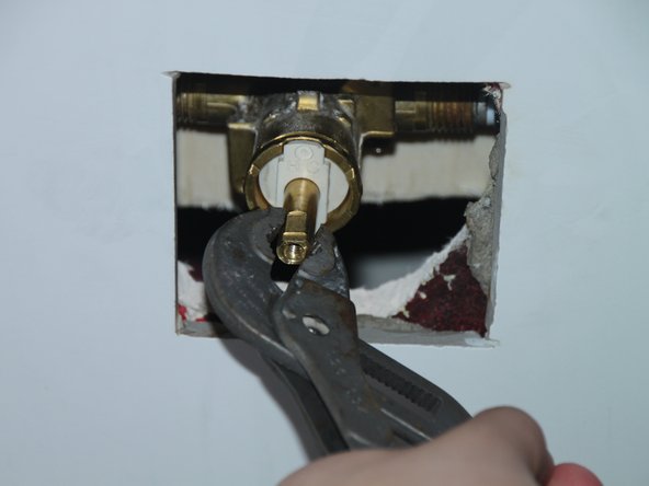

    • Slide the tip of needle-nose pliers under the notch of the retaining clip and pull the clip upwards.
  10. Moen Posi-Temp Cartridge Part #1112b Replacement: crwdns2935265:010crwdnd2935265:01crwdnd2935265:03crwdne2935265:0 Moen Posi-Temp Cartridge Part #1112b Replacement: crwdns2935265:010crwdnd2935265:02crwdnd2935265:03crwdne2935265:0 Moen Posi-Temp Cartridge Part #1112b Replacement: crwdns2935265:010crwdnd2935265:03crwdnd2935265:03crwdne2935265:0

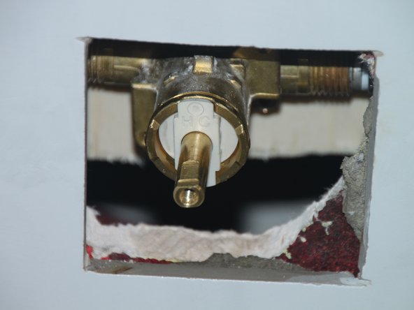

    • Clamp firmly onto the brass tube with a pair of vice grips and gently but firmly pull out the cartridge.
  11. Moen Posi-Temp Cartridge Part #1112b Replacement: crwdns2935265:011crwdnd2935265:01crwdnd2935265:02crwdne2935265:0 Moen Posi-Temp Cartridge Part #1112b Replacement: crwdns2935265:011crwdnd2935265:02crwdnd2935265:02crwdne2935265:0
    • Insert the new Moen Posi-Temp cartridge.
  12. Moen Posi-Temp Cartridge Part #1112b Replacement: crwdns2935265:012crwdnd2935265:01crwdnd2935265:01crwdne2935265:0
    • Insert the new cartridge into the valve assembly.
    • Ensure that the H/C symbols are facing up.
    • Ensure that the notch on the brass tube is also facing up.
