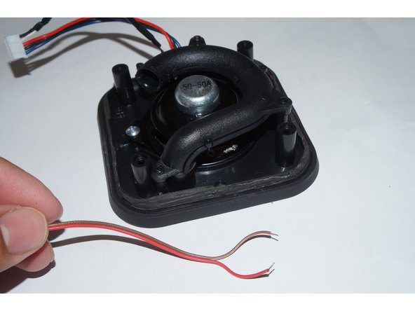

    • Use the plastic opening tool to pull the metal cover off the top of the speaker.
  2. Modal MD-SPBT01 Speaker Wiring Replacement: crwdns2935265:02crwdnd2935265:01crwdnd2935265:01crwdne2935265:0
    • Remove the four screws that are inside the holes on the top of the speaker.
    • Use a Phillips 00 screwdriver to remove the 10mm screws.
  3. Modal MD-SPBT01 Speaker Wiring Replacement: crwdns2935265:03crwdnd2935265:01crwdnd2935265:01crwdne2935265:0
    • Pull the top piece of the speaker off to allow access to the interior.
  4. Modal MD-SPBT01 Speaker Wiring Replacement: crwdns2935265:04crwdnd2935265:01crwdnd2935265:01crwdne2935265:0
    • Locate the speaker wire connection and remove the wiring.
    • Locate the LED lighting wire and remove that as well.
  5. Modal MD-SPBT01 Speaker Wiring Replacement: crwdns2935265:05crwdnd2935265:01crwdnd2935265:01crwdne2935265:0
    • Once you disconnect the wires, you can remove the speaker.
  6. Modal MD-SPBT01 Speaker Wiring Replacement: crwdns2935265:06crwdnd2935265:01crwdnd2935265:02crwdne2935265:0 Modal MD-SPBT01 Speaker Wiring Replacement: crwdns2935265:06crwdnd2935265:02crwdnd2935265:02crwdne2935265:0
    • Remove the positive and negative connections for the wiring to fully disconnect the wire.
    • Now that you have removed the defective wiring, you can install a new one.
