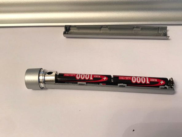

  1. Mobee Magic Bar Replacement Batteries, Remove device: crwdns2935265:01crwdnd2935265:01crwdnd2935265:01crwdne2935265:0
    • Remove the device from the keyboard.
  2. Mobee Magic Bar Replacement Batteries, Remove screw: crwdns2935265:02crwdnd2935265:01crwdnd2935265:01crwdne2935265:0
    • Locate the screw on one side. Remove it.
  3. Mobee Magic Bar Replacement Batteries, Body opening: crwdns2935265:03crwdnd2935265:01crwdnd2935265:01crwdne2935265:0
    • Using a knife, gently bend the latches.
  4. Mobee Magic Bar Replacement Batteries: crwdns2935265:04crwdnd2935265:01crwdnd2935265:02crwdne2935265:0 Mobee Magic Bar Replacement Batteries: crwdns2935265:04crwdnd2935265:02crwdnd2935265:02crwdne2935265:0
    • Remove the old batteries and install new ones. Observe polarity. Next, assemble the device.

The link provided for the replacement batteries are not rechargeable batteries. Don't we need to replace with rechargeable ones?
Shawn Amidi - crwdns2934203:0crwdne2934203:0
do we need to use rechargeable batteries
Jacqueline Diaz - crwdns2934203:0crwdne2934203:0
Do we need rechargeable battery ?
Andrew B - crwdns2934203:0crwdne2934203:0
Yes, you need a rechargeable AAA battery.
