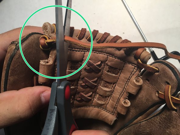

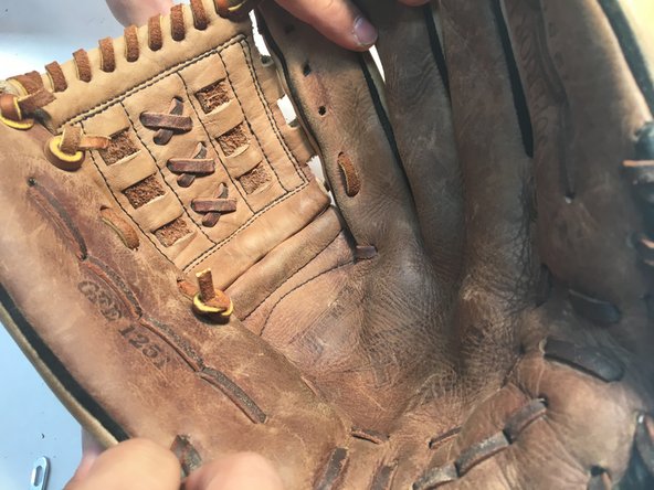

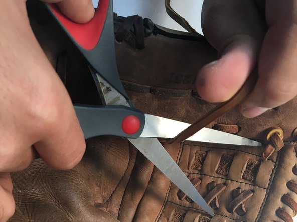

    • Untie the knot 1.
    • If you are having trouble, you can cut it with scissors.

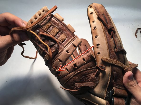

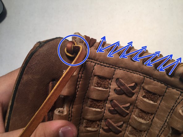

  2. Mizuno GFE1251 Baseball Glove Lacing Replacement: crwdns2935265:02crwdnd2935265:01crwdnd2935265:01crwdne2935265:0
    • From where the knot was, start unweaving the lacing.
    • To unweave the lacing, pull it through all of the holes, until you get to the next section.
    • The lacing is hard to pull through the glove and requires quite a bit of manpower.
    • The first section continues up until the pocket.

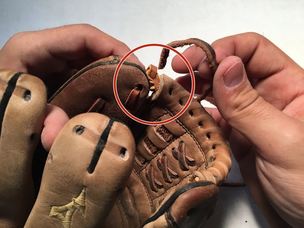

  3. Mizuno GFE1251 Baseball Glove Lacing Replacement: crwdns2935265:03crwdnd2935265:01crwdnd2935265:03crwdne2935265:0 Mizuno GFE1251 Baseball Glove Lacing Replacement: crwdns2935265:03crwdnd2935265:02crwdnd2935265:03crwdne2935265:0 Mizuno GFE1251 Baseball Glove Lacing Replacement: crwdns2935265:03crwdnd2935265:03crwdnd2935265:03crwdne2935265:0
    • This section is difficult to unlace and may need the assistance of a tool to get it lose. We have used the unlacing/lacing tool that came with the our kit.
    • This is the pocket section.

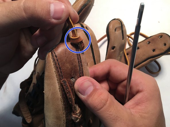

  4. Mizuno GFE1251 Baseball Glove Lacing Replacement: crwdns2935265:04crwdnd2935265:01crwdnd2935265:03crwdne2935265:0 Mizuno GFE1251 Baseball Glove Lacing Replacement: crwdns2935265:04crwdnd2935265:02crwdnd2935265:03crwdne2935265:0 Mizuno GFE1251 Baseball Glove Lacing Replacement: crwdns2935265:04crwdnd2935265:03crwdnd2935265:03crwdne2935265:0
    • Trace along the pocket and when you come to the end untie the knot.
    • We have now unlaced all of the glove.

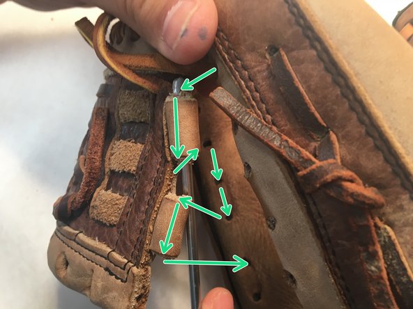

  5. Mizuno GFE1251 Baseball Glove Lacing Replacement: crwdns2935265:05crwdnd2935265:01crwdnd2935265:03crwdne2935265:0 Mizuno GFE1251 Baseball Glove Lacing Replacement: crwdns2935265:05crwdnd2935265:02crwdnd2935265:03crwdne2935265:0 Mizuno GFE1251 Baseball Glove Lacing Replacement: crwdns2935265:05crwdnd2935265:03crwdnd2935265:03crwdne2935265:0
    • Start by weaving the lace through the lacing tool as shown.
    • Weave through spot A and then tie a knot.
    • Weave the lace through the pattern shown

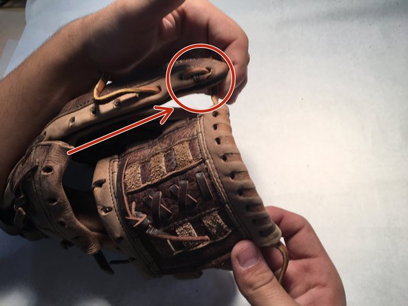

  6. Mizuno GFE1251 Baseball Glove Lacing Replacement: crwdns2935265:06crwdnd2935265:01crwdnd2935265:03crwdne2935265:0 Mizuno GFE1251 Baseball Glove Lacing Replacement: crwdns2935265:06crwdnd2935265:02crwdnd2935265:03crwdne2935265:0 Mizuno GFE1251 Baseball Glove Lacing Replacement: crwdns2935265:06crwdnd2935265:03crwdnd2935265:03crwdne2935265:0
    • Weave the lace through spot B.
    • Follow the pattern shown and tie a knot at spot C.
    • Make sure to pull this section tighter than the rest.
    • Cut off the extra lace.
    • We have now used the first length of lace.
