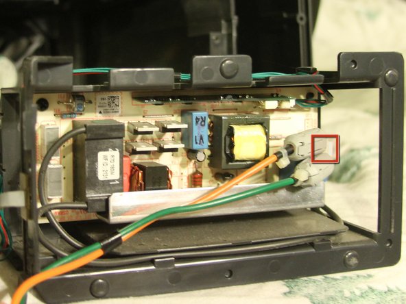

  7. Mitsubishi WD57734 Lamp Ballast Replacement, Lamp Ballast: crwdns2935265:07crwdnd2935265:01crwdnd2935265:01crwdne2935265:0
    • Pull up and unsecure the orange and green power connection wires that are being held down by the white clamps and black cable hooks.
  8. Mitsubishi WD57734 Lamp Ballast Replacement: crwdns2935265:08crwdnd2935265:01crwdnd2935265:01crwdne2935265:0
    • Pull straight back on the lamp ballast housing to remove it from the television.
  9. Mitsubishi WD57734 Lamp Ballast Replacement: crwdns2935265:09crwdnd2935265:01crwdnd2935265:02crwdne2935265:0 Mitsubishi WD57734 Lamp Ballast Replacement: crwdns2935265:09crwdnd2935265:02crwdnd2935265:02crwdne2935265:0
    • Disconnect the orange and green power connection from the lamp ballast by holding the white tab on the connector and pulling straight out.

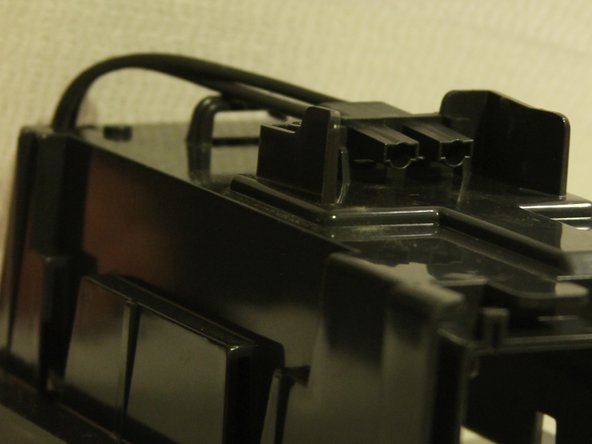

  13. Mitsubishi WD57734 Lamp Ballast Replacement: crwdns2935265:013crwdnd2935265:01crwdnd2935265:02crwdne2935265:0 Mitsubishi WD57734 Lamp Ballast Replacement: crwdns2935265:013crwdnd2935265:02crwdnd2935265:02crwdne2935265:0
    • Pull the lamp ballast out of its housing.
    • The lamp connection that is on the back of the lamp ballast housing should have its flat side facing away from the ballast housing when you are putting the t.v. back together.
