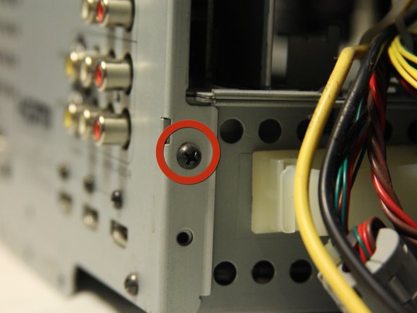

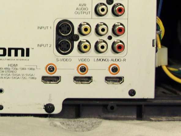

    • Remove the following 11 screws from input/output panel.
    • Eight 12 mm Phillips #1 (one screw on each side and six screws on the front panel).
    • Three 10 mm black, fine thread Phillips #0 screws above the HDMI ports.
