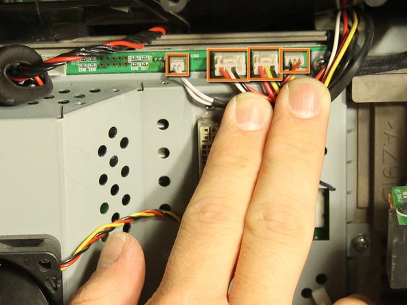

    • Disconnect the light engine power cable by holding its white tab and pulling straight back.
    • Disconnect the four connections above the black data connection by gently pulling the plugs out of the sockets (some of the connections have a tab that must be pressed when pulling to disconnect).

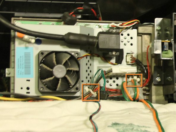

    • Disconnect lamp ballast power and data connections in front of the light engine by pressing their corresponding tabs and pulling them apart.
    • Release the cables from the white cable ties by twisting the white cable clasps and pulling the cables out of the clasps.

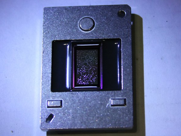

    • Lay the board facedown on a smooth surface.
    • Do not touch front of the dlp chip. Oils or dust will distort the tv image.
    • Use a small flathead screwdriver to turn the locking screw half a turn counterclockwise.
    • Remove DLP chip from the light engine board by pulling it straight back.
    • The photo shows an example of a broken DLP chip with hundreds of stuck pixels.
  12. Mitsubishi WD57734 DLP Chip Replacement: crwdns2935265:012crwdnd2935265:01crwdnd2935265:01crwdne2935265:0
    • During reassembly after installing the new DLP chip, it is recommended that you remove the old thermal paste from the DLP heat sink with a thermal compound remover and purifier.
    • After removing the thermal compound, apply a small amount of new thermal compound (about the size of a grain of rice) and use a card to apply it evenly over the surface of the heat sink that will be in contact with the chip. This will improve the cooling of the chip during use and will prevent overheating that caused failure of the old chip.
