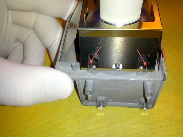

Remove both screws as shown and gently pull the metallic frame. It is anchored on two small notches on the other side.

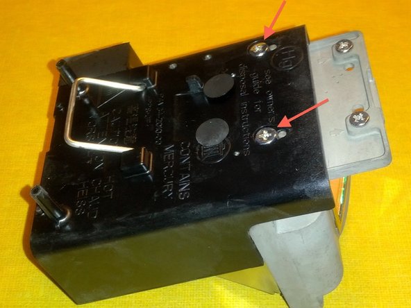

Remove both screws onn the handle side, and both dark screws on the opposite side.
Slightly pull the metal frame (1) and lift the housing top half (2) to reveal the bulb.

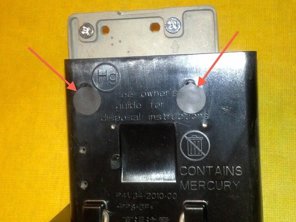

Remove the black stickers hiding both screws that will have to be removed in this step.

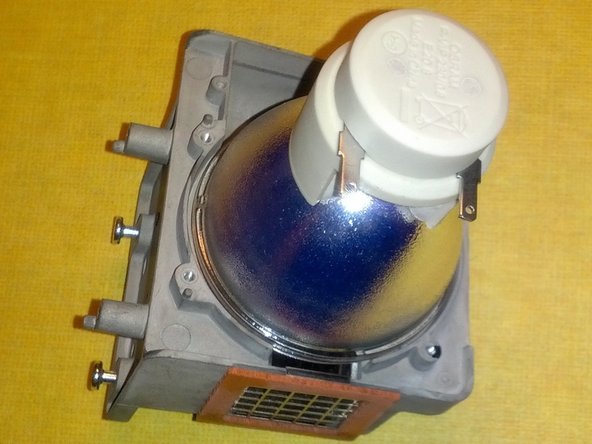

Lift the bulb and its holder from the housing frame.
It will then be easier to disconnect the cables
Remove the 4 screws and gently lift the frame maintaining the bulb.
Note the two notches which will only allow one way to mount the frame.
Note the bulb's contacts orientation.
